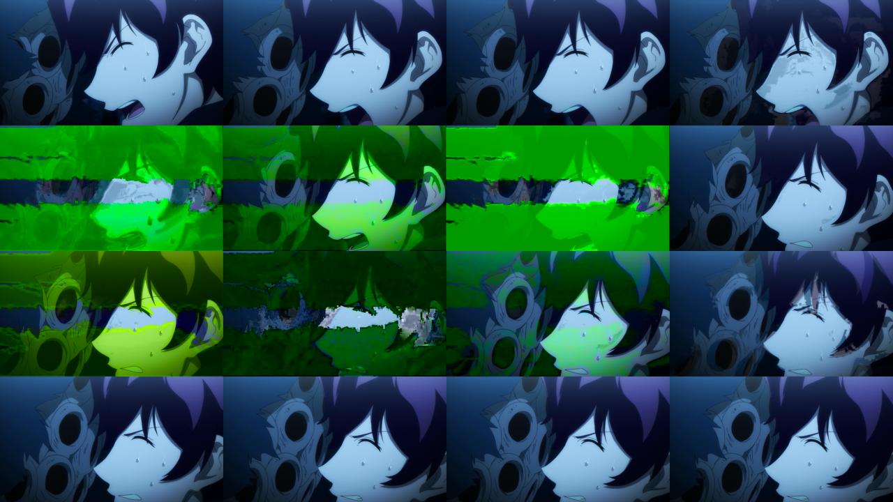

It may not help the OP whose video has bursts of several frames with bad frames (thumbnails of 16 consecutive frames, top left to bottom right):
[Attachment 39881 - Click to enlarge]

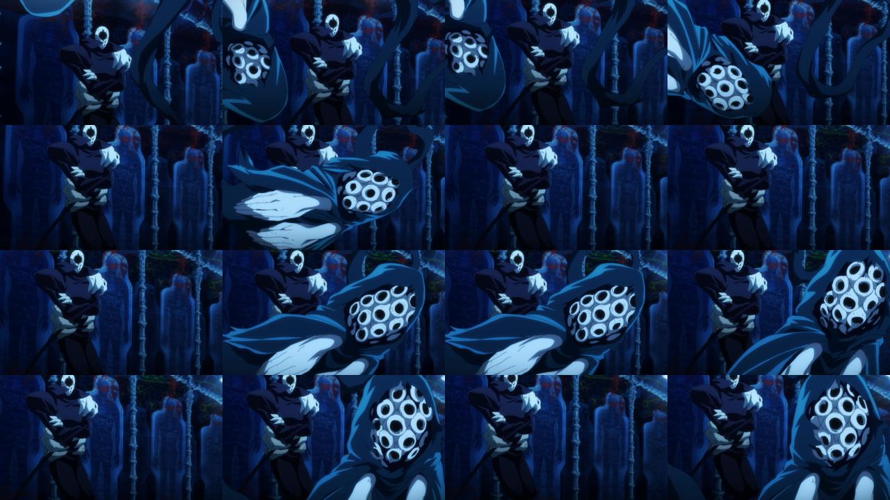

It also has single frames that are significantly different from surrounding frames but are not errors:
[Attachment 39882 - Click to enlarge]
But I'd like to see your "flash detecting" script. -
