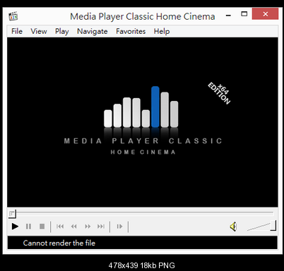

    when i playing video and pull a ass file to mph-hc,the ass file will replace the video.look like the image
    In past,when video playing ,i just put .ass into mph ,the subtitle will show with video.I can't do it now.
    how to let the mkv and ass work together? thanks

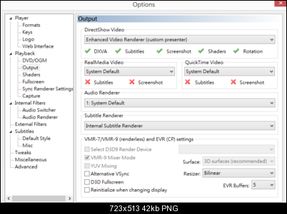

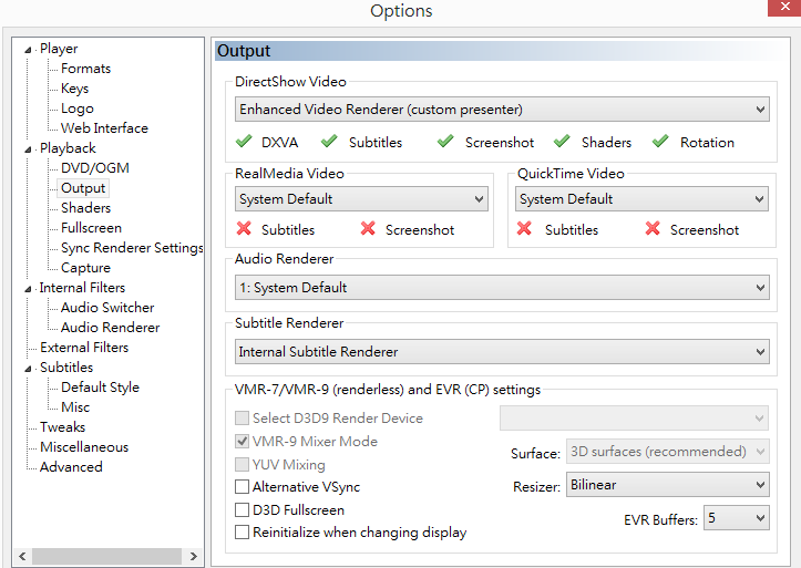

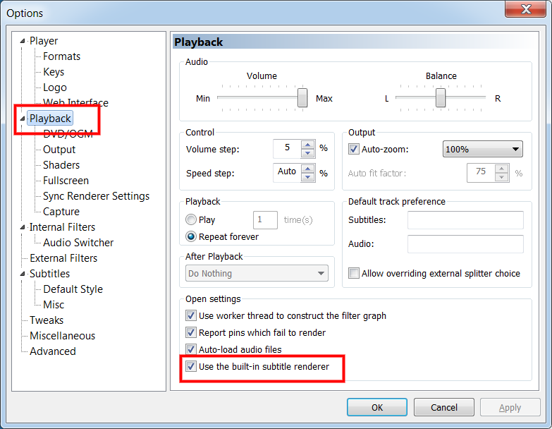

  2. It only works with the "Internal Subtitle Renderer" (ISR). Select it via Playback->Options->Output.
  3. Thank you.
    are you say this page ?
    i had use ISR,but it doesn't work.
  4. Yes, that setting. I don't know why it doesn't work for you. Is only this specific ass file affected? Do srt files work? Does the ass file work if you put it in the same folder as the video file and name it as the video file (except .ass extension)?

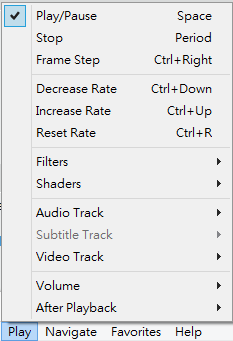

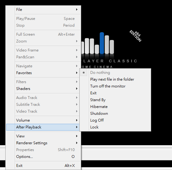

  8. yes , i go to menu when the video playing ,and it show me that
    subtitle track can not use
    Am i go to wrong place ?

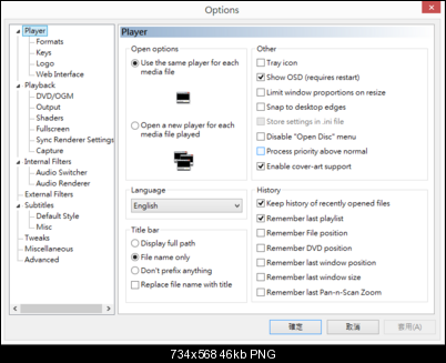

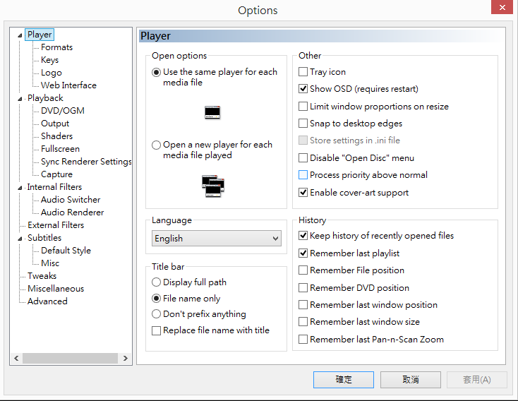

    it doesn't provide button to let me tick.

  13. Originally Posted by kk9 View Post
    Originally Posted by sneaker View Post
    I just don't understand it. It shouldn't be happening as long as "Internal Subtitle Renderer" is chosen...
    It's in the Playback section (left pane), bottom of the right pane.
  14. Originally Posted by jagabo View Post
    Do you mean it ?

    [Attachment 39863 - Click to enlarge]
  17. He doesn't have that box because his MPC-HC isn't outdated. It was replaced by the subtitle renderer selection drop-down menu you see in his screenshot in post #3.
    Anyways, I think he meant the "Store settings in .ini file" box. It is greyed out which is okay (means no writing rights). To reset settings he just has to run the .reg file (or manually delete the registry keys).
