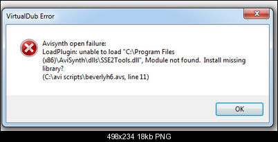

  1. I'm doing an install of AviSynth on a brand new computer with a new install of windows and I can't figure out what I'm doing wrong. I'm using Windows 7 Ultimate 64-bit.
    I think it's files that go into the system32 or SysWOW64 folders I'm missing?? These exact same files I have setup on two other computers and they work perfectly fine.
    I installed Avisynth 2.6 and VirtualDub 1.10.4 and copied all my DLL folder and plugins folder over so everything is the same but the extra files you put in those folders mentioned above?
    Anyways here is the script (I preload all plugins) and error message attached:

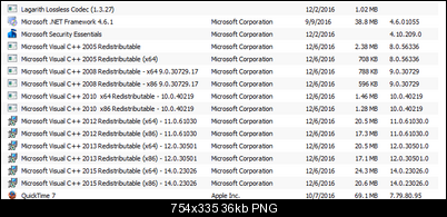

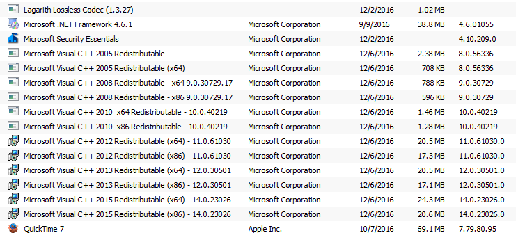

  5. Here is a picture of all Visual C++ run-time packages I have installed
    I think I have all the required ones as I checked my other computers that have AviSynth working correctly and dont see that I'm missing any?
    Does this help?

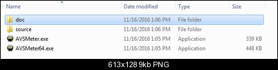

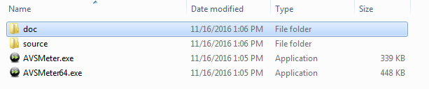

    I downloaded this, not sure how to install as there are 2 exe files?
    and it is acommand line interface?
    not my strong point Click image for larger version

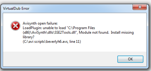

    now I get the following error
    only made it 2 more lines down
  9. SSE2Tools requires MSVCR71.DLL. Not sure which VC runtime includes that.
    Regarding AVSMeter: just run it from a batch file:
    "G:\Program Files\AvsMeter190\AvsMeter.exe" %1
    Pause
    You can drag/drop an AVS script onto that batch file. Or, put the batch file in your SendTo folder and you can right click on a AVS script and select SendTo -> batchname.bat (batchname.bat is whatever you called the batch file, I called it AVSMeter.bat). Be sure to change the path to where you have it extracted.
