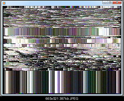

    So to continue, I have several issues trying to convert old tapes. The first is oldest tapes, which have this sort of noise mixed with good video, and no sound:
    The second is missing audio when I do get a reasonable picture - nothing. I don't have and don't remember the original hi8 camcorder I recorded these with, but I do know I never played with any audio settings on that past camcorder. I keep hearing about PCM audio, but a Sony TRV520 should play sound.
    And then this morning, on a newer tape, the tape plays, with sound, but it acts as if each frame is a new video (inside scene analyzer 4.0) and from the playback in the camcorder plays slightly staccato.
    Thoughts?
    Aug 2010
    San Francisco, California
    Starting to sound like a combination of dodgy tapes and tracking issues with your TRV-520. 8 mm tolerances are notoriously small and audio (which is AFM laid down with the video) is often the first thing to go. It's unlikely you recorded PCM audio, but if you did, it won't play on the 520.
