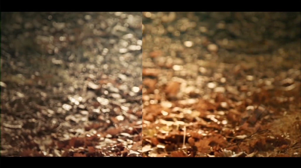

Some particular clips, when encoded to H.264 vastly change the colors to more warm, despite increasing resolution. Here's a difference 576 vs 720:
The left one is the 576 and the right one the 720, which I have scaled down in paint to compare them better. The 576 has the original colors and somehow the 720 natively comes in these fake colors after ripping. And when I encode the 576 (btw I use the free Any Video Converter to do this), the colors change to fake. Now I would like to know both how to prevent the color change with encoding and how to get the original colors back on the 720. I couldn't find any color filter option in Any Video Converter.

	Check colorimetry (must be correct and SD usually use BT.601 and HD usually use BT.709), side to this frequently HD versions (remaster or improved) may have have some tweaks on contrast and saturation to create impression of more vivid picture (marketing approach to show advantage of HD over SD).
	I'd start by not using Any Video Converter, or check for any colour enhancing options that might be enabled. I'd try Handbrake or Vidcoder instead. They're not hard to use and won't mess with the colours. Are you sure the DVD and Bluray sources don't look just as different? I could be wrong but that seems to be more than just a colorimetry difference (high definition and standard definition are converted to RGB on playback slightly differently so upscaling or downscaling can cause the colours to look a little different).
