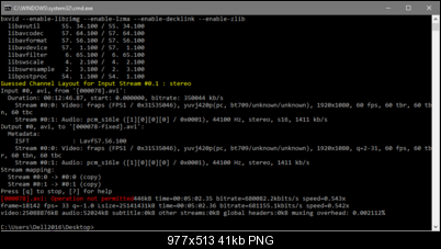

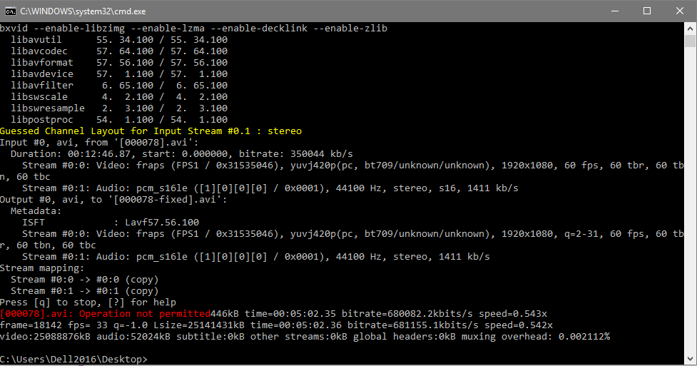

  21. Originally Posted by Nawaffles View Post
    The ffmpeg is working, but it stopped almost halfway through with the error "Operation not permitted".
    Was that a Windows error or an ffmpeg error? Screenshot please.
  22. Here is a screenshot.
  23. Member
    Aug 2010
    San Francisco, California
    That's a fatal FFmpeg error. Looks like it tripped up on unexpected conditions in the file. If I were you, I would try DivFix++ which is in the software library here..
  24. I agree, for the second time, with the DivFix suggestion. Nawaffles, please try DivFix++.
    For the curious, regarding "Operation not permitted", it's error code EPERM, which is rarely used within ffmpeg, in fact it appears in only three files: concatdec.c, rtsp.c and os_support.h. The last is the likely source: a function called win32_rename. It looks to me like it's a directory write permission problem - but who knows, unexpected conditions in the file (ie the file is damaged/unrecoverable) can cause a lot of strange things to happen.
