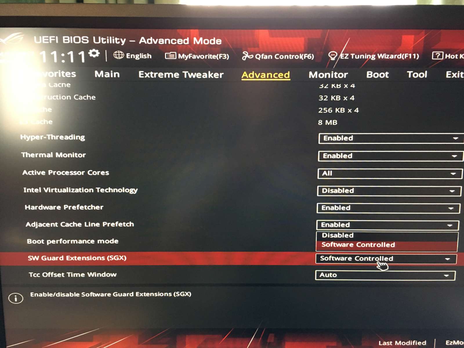

    1) Yes I have found a page on my motherboard's product website (the design page rather than spec) that does say its ports are HDMI 1.4b and DisplayPort 1.2 (both of which don't support HDCP 2.2)
    2) The good news is the discrete GPU that I am waiting for has both HDMI 2.0b and DisplayPort 1.4. From my research it seems both will support HDCP 2.2 so will this solution work or is it a MUST to use the onboard Intel HD 630 GPU??
    3) Lastly I have a slight glimmer of hope while looking through the BIOS for SGX. Found the setting in the attached screenshot but am not sure whether this is what is required. Could you kindly take a look? The only options are 'Disabled' and 'Software Controlled'. I was expecting to find an 'Enabled' option but didn't.
    Thanks in advance once again.
  2. 1) Does HDMI 1.4b really not support HDCP 2.2? Of course you can't send 4Kp60 10 bit without HDMI 2.0 because of the lacking bandwidth but movies are usually 24 Hz anyways.
    2) At the moment: yes. But it might be possible that with new GPU drivers/software updates discrete GPUs become usable. But at this moment nothing is certain so I wouldn't buy a GPU right now. (Best chances probably with Nvidia Pascal)
    3) "Enabled" does exist but not on all mainboards. I don't know if this is relevant for PowerDVD, though.

    Hello sneaker.
    2) What is the reason only HD 630 can be used to play 4K UHD Blu-Rays? What specific technology in this makes it compatible? Yes the GPU will be the 1080 Ti. I won't wait longer as the PC has been around for over 2 months without a GPU thus it's already wasting my money not being able to play games. If the 1080 Ti won't do UHD blu-ray discs it won't be a deal-breaker.
    3) Ahh OK but would this 'Software Controlled' option suffice for PowerDVD? I've just seen that intel URL that you've shared. I guess it depends whether PowerDVD will request for it to be enabled via software control. It would make more sense that it does so.
    Thanks!
