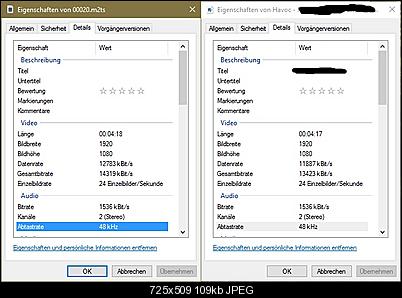

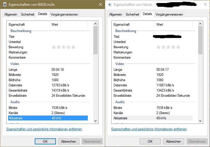

  3. Click image for larger version
    This is where I've looked it up. And sorry, the M2TS bitrate is a little more than 12719. My bad. Is this how I can compare it or must I do a calculation? And even if, why can I see a difference in the video? By the way, this doesn't affect all muxes, but mostly the 1080p videos.

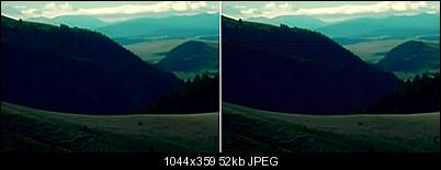

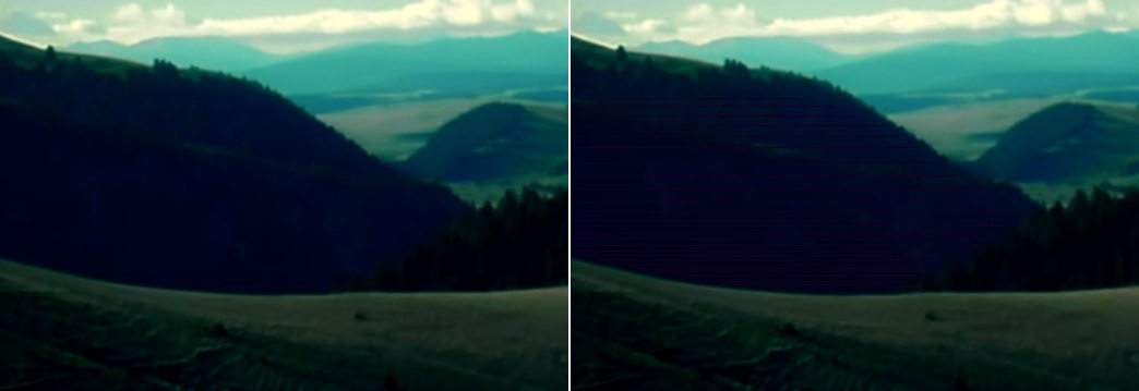

  7. As sneaker already mentioned, I would waste my time comparing the videos unnecessarily since it doesn't bother me, because the difference is practically zero. But I will leave a screenshot in a few minutes just to show you what I mean.
    Edit: Well, it only appears in motion of the pictures, so I can't make a screenshot. It's quite distinct. But let's leave it by that. Here's what it roughly looks like (did it with GIMP):
