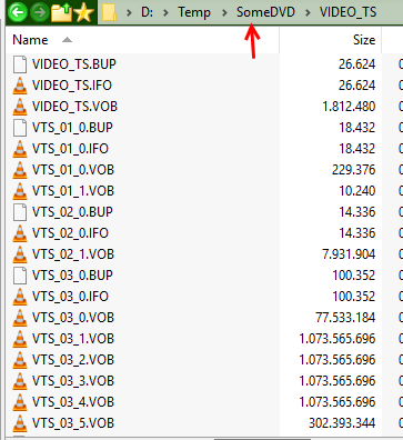

  13. Just for good order's sake, say, the DVD on HDD is titled SomeDVD
    with a subfolder VIDEO_TS (that includes the .vob, .ifo. .bup files)
    then I rightclick on SomeDVD and play the video (or alternatively I might rightclick the VIDEO_TS folder and play it).
    It is not an .ISO but all the different files, you know.

    [Attachment 39810 - Click to enlarge]
