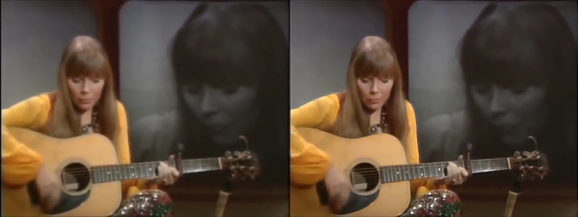

    You generally can't sharpen much without creating and exacerbating artifacts. With material like this you can sharpen edges but there's no detail in between those edges. Any small, low contrast detail in the analog tapes has been blurred away by the low bitrate encoding. So when you sharpen everything looks cartoonish, people look like mannequins, etc. This example is overdone but it gives you an idea what happens. Original 720p download on the left, sharpened on the right.
    [Attachment 39749 - Click to enlarge]

    As hech54 suggested, the OP would save a lot of time and then have an infinitely better result if he started with the DVD. I just did a quick search and it can easily be found for well under $20. My image grab compared to your image from your excellent restoration of the YouTube video shows how much more detail can be had. The audio is also going to be better, something that is very important for a music performance.

    LOL. No it's terrible. I deliberately went overboard to highlight the expected problems. The Hubble Space Telescope scientists were able to do much better (before the repairs) because they started with blurry but not highly overcompressed images. And they knew exactly what was wrong with the telescope's lenses so they could reverse the distortion. And Adobe's un-motionblur algorithm works much better with when the images aren't over compressed.

  13. I was playing with the script so this may not be the exact settings I used:
    LWLibavVideoSource("Joni Mitchell   Both sides now on Mama Cass Show 1969.mp4")
    AddBorders(2,0,0,0) # mod4 width
    src=last # remember the source
    Spline36Resize(360, 360) # close the real resolution of the video
    MergeChroma(last, aWarpSharp(depth=20)) # sharpen chroma
    Sharpen(0.7, 0.5) # sharpen everything
    Santiag() # antialias
    nnedi3_rpow2(4, cshift="Spline36Resize", fwidth=src.width, fheight=src.height) # upscale back to original size
    aWarpSharp(depth=10) # sharpen and smooth edges
    Sharpen(0.3) # sharpen more
    McTemporalDenoise(settings="medium", enhance=false) # denoise
    #TemporalDegrain(SAD1=200, SAD2=150, sigma=8) # alternate denoise
    ChromaShift(c=2, l=-2)
    StackHorizontal(src,last) # put them side by side, or Interleave()
    There's a lot to play with.
