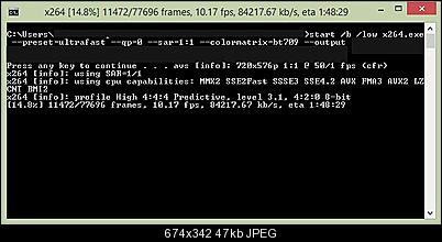

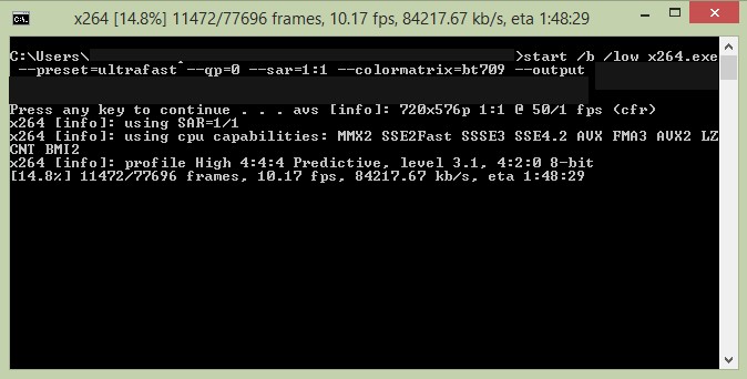

    I am wanting to make these videos the best possible quality of progressive, not interlace. So minor degradation is fine if it means the outcome is progressive (i am using QTGMC).
    Is there any quicker way of deinterlacing with QTGMC?
    I am running the avs script through x264 command line using the setting preset=ultrafast but even at ultra fast its only going at 10 fps. 2 hours encoding for 20min video seems pretty time consuming considering the workload, its going to take months.
    So is this a normal speed?
    Its not my CPU (i5) keeping it slow as its only running at 39%.
    I did try re-encoding to the same (huffyuv) using vdub, but that was going to take even longer.

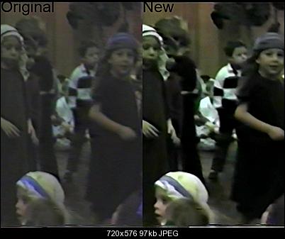

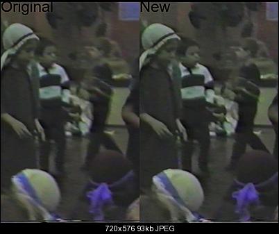

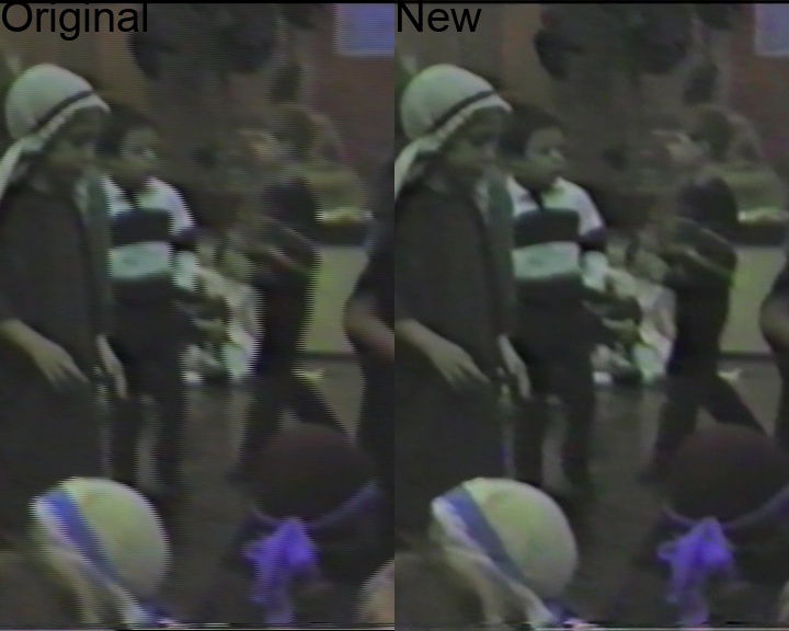

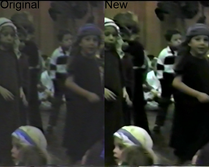

    After a while of trying different things and trying to learn avisynth, this is what i have so far...
    (video file attached)
    The filters i have used are as follows:
    McTemporalDenoise(settings="medium", interlaced=true)
    Tweak(sat=0.3, startHue=290, endHue=004)
    Tweak(sat=1.9)
    ColorYUV(gain_y=190, cont_y=90, off_y=-30)
    As well as the obvious resize, qtgmc, converttoyv12..
    Where else could i take this? it looks better that the original but i think its still quite off, i just dont know what else to do.
    Baring in mind i'm only just learning avisynth, what suggestions, tips or advice would you give me on this?
