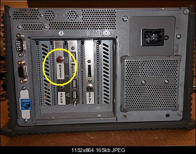

    Simplest would to just use the existing and working 'reset' switch for power.
    And you could always add a common pushbutton switch hooked to the old 'power' switch cable and drill a
    small hole on the back of the PC and place the reset switch there. How often do you use the reset switch anyway?
    If you really want to replace the original switch, most of the front panels of PCs are removable at the inside sides of the PC case.
    Power switches are often hot glued in place and not that hard to remove or replace the same way.
    Some are 'snap in'. But finding an exact match for the original switch isn't too likely.
    I used a remote mounted reset switch for this computer build:

  10. Just swap the wires for the reset SW on the mobo. Takes seconds, no expense, no problem.
    Most likely prob with the actual switch is a binding of the plastic external button, or possibly some foreign object jamming the actual switch. Rare that they are actually defective, but not impossible. Most are simple and identical and you could pull one off a discarded PC, or, again, just use the existing Reset SW. You could swap the external switch position on the case if you want to make more work for yourself.
