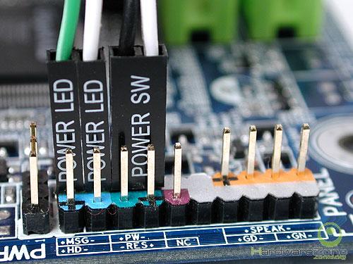

  15. Maybe power button not working properly
    try test by disconnect all USB, LAN cable, mouse, keyboard ...
    only power connected to power supply
    remove connector of power button the POWER SW from motherboard:
    Now short POWER pins on motherboard with screwdriver to power on/down
    same problem?
    same problem?
    The pins are difficult to reach inside the case and I am not sure if it's a good idea to try shortening them with a screwdriver.

    You can also switch the reset switch terminals for the power switch terminals on the MB. They are both momentary switches. I've had the switches fail.
    The screwdriver trick is safe. Those terminals are all at logic levels and you are just bringing one to ground,
    the same as the switch does.
    But your problem may also be a software one where the shutdown cycle is hanging and the PC reboots.

    Okay, maybe the power and reset buttons are not connected to the motherboard correctly, so that pressing "Power" activates "Reset."
    Take a look at post #15 again - the "PW" and "RES" connections are small and located close together; a mistake could easily have been made.
    same problem?
