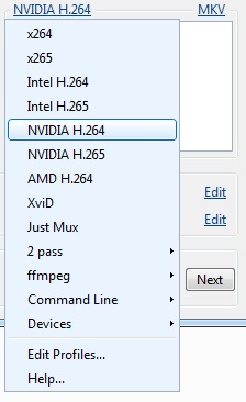

    What I did in StaxRip was
    - install StaxRip x64 1.3.7.0
    - load the input video
    - change codec to "NVIDIA H.264"
    - go to "Encoder options" and change decoder to "NVEncC (avcuvid cuda)"
    - I left all other options unchanged after the installation
    From the word cuda I concluded it must be the same thing that I used to make the encoding quicker in DVDFab but now I am not sure if these are in fact two different things or not.
    Screenshots are attached.
