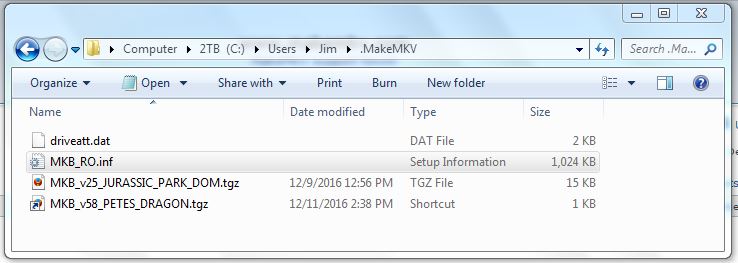

    Well, the MakeMKV part went fine (as usual).
    When I tried to follow the ImgBurn suggested process (which is what I've usually done), I still have the same problem. MKV creates a .tgz file which ImgBurn can't use.
    I used Winzip to unzip the file since I was told and verified .tgz is a zipped file. The unzipped files are: "driveatt.dat (2kb)" and "MKB_RO.inf. (1024kb). Obviously, these are not BR files. so I'm back to my post #20.
    Is there a way to tell ImgBurn the type of file to create as the output? What the heck am I doing wrong? I'm 73 but not yet fossilized, so I've got to be missing something really ridiculously simple.

    You are looking in the wrong place. There are similar tgz files in the MakeMKV folder in my User folder, but that folder doesn't contain the output from the decryption process. The output from the decryption process is elsewhere, in a folder that I selected in step 6. There are 2 folders that you need to burn, "BDMV" and "CERTIFICATE". Search your computer for "BDMV". "CERTIFICATE" should be in the same folder with "BDMV".

    usually_quiet,
    Well, in my MakeMKV settings, my default destination directory is C:\Users\Jim/.MakeMKV. The attached image shows what I find in that directory:
    The Pete's Dragon entry is a shortcut because as I said earlier, I used Winzip to extract the original Pete's Dragon .tgz file. The .dat and .inf files are the extracted files.
    So where else could the files be? I've done a search on my computer and these are the ONLY MKB files found.
    I registered on the MakeMKV website yesterday and the resulting answer to my post was pretty much what you have been saying in your posts to me.
    Something's wrong and it's driving me nuts! I'm about ready to write off the purchase of MakeMKV as a learning experience.

    This is the first time you mentioned which movie you are trying to copy. It is likely that MakeMKV has not yet been updated with the information it needs to rip "Pete's Dragon" since it was released quite recently. It doesn't matter which ripper you buy, there are times when you must wait to be able to copy some movies.
    You don't need to find MKB files. There are 2 folders that you need to burn, "BDMV" and "CERTIFICATE", so that is why I asked you to look for "BDMV". As I wrote in my earlier post, "CERTIFICATE" should be in the same folder with "BDMV".
    Over the weekend, I did a rip of "The Hobbit: Desolation of Smaug" so I could write down the precise steps for you. It took MakeMKV about 30 minutes to finish ripping the complete backup. My destination folder was K:\Video\backup\THE_HOBBIT_DESOLATION_OF_SMAUG. THE_HOBBIT_DESOLATION_OF_SMAUG contains a total of 33.9 GB in 3 folders: BDMV, CERTIFICATE, and MAKEMKV.
    Since you are seeing none of the folders that should result from a successful rip, it looks like "Pete's Dragon" is too new for MakeMKV to copy.
    [Edit]I have no idea why you can't find any files or folders for "Jurasic Park". It is not a new movie, and MakeMKV can only produce Blu-ray rips as MKV files (i.e moviename.mkv) or complete backups of the BDMV and CERTIFICATE folders.

    I got another post on the MakeMKV forum. This was suggested: ""Load a BD. Click on "Backup". What directory shows up under "Please specify output directory"?"".
    That was the problem! MakeMKV was actually sending the BDMV and CERTIFICATE files to C:\Video\backup, NOT the default directory specified in "Settings". I have no idea why Windows Explorer did not (and still doesn't) find these files.

    Step 6 meant type in an answer to "Please specify output directory" in the dialog window. I guess the description of what to do there needed to be more explicit.
    BDMV and CERTIFICATE are folders. They each contain a number of files and sub-folders. I have no idea why you could not find the "BDMV" folder. When I typed "BDMV" into the Windows Explorer search box, Windows had no trouble finding the BDMV folder for me. ...and I had I set up the search to examine the entire computer, not just one drive or the Libraries.
