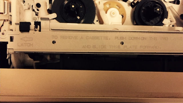

  1. I'm trying to figure out what's wrong with my VCR. It worked fine yesterday but today when I put a tape in, the VCR will eject it right away. The display has always been really faint so I can't tell if the fault code is A2 or H2.
    The service manual says H02 fault code is "Cassette tape is not wound up during tape unloading, except in Eject mode. Check the capstan motor drive circuit." Seems my issue is when the tape is being loaded, not unloaded... so not sure what to make of it.
    Any ideas?
    Here's a YouTube video I shot of this happening. Notice in the 4th attempt it's clear the VCR is trying to move the tape, but then gives up.
    https://youtu.be/cX9IO7LImv0
    Thanks,
    -Pete

    Press up on the reel lock (through the round hole in center bottom) and advance the tape past the clear leader. Then see what happens. Is your capstan turning? Is the pinch roller making contact? A video from the front-left would be helpful.
  3. If you are trying to get it to play with the cover off, there is a light sensor in most VCRs that, when the cover is off, gets activated by the light in your shop and will cause the tape to eject. Turn off the lights and try it again. If that works, then find out where the sensor is (others in this forum may be able to tell you because this is a well-known model) and you can cover it up with some low-residue removable tape.
  4. Hi, thanks for the replies.
    JVRaines, I manually advanced the tape beyond the clear leader and it still ejects the tape.
    johnmeyer, this problem first started happening a few days ago when the cover was on. I did try it again with the lights off and the top covered and it still happens.
    I also noticed the pinch roller isn't lowering.... weird.
    If it helps, I shot another video showing more angles including a view with the bottom cover removed.
    https://youtu.be/djqBuBYXG0k
    -Pete

    There is a cam gear inside the pinch arm unit that is supposed to lower the roller into play position. If it's not turning, there could be a gear problem underneath. Or maybe the piece is hung up and needs lubrication. Or the mechanical linkage is broken. In any case, some serious disassembly is required to diagnose the issue.
  6. ... and if you disassemble it, you will probably never get the timing gears aligned correctly unless you have service experience and a manual.

    It's not quite that scary. The service manual is pretty good on this one. I would start by getting circuit boards out of the way so you can see what's going on with the gears. If you decide to take any gears or belts apart, take pictures of the timing marks first or make your own marks with a Sharpie so you can line them up again.

    You might find the Type 29 Mechanism section of this manual helpful for an overview. Examine the gears closely for timing marks, which may be bumps, indentations or holes.

    I will just add that yesterday my own HD660 - same loading as the AG1800 - would just eject a tape. In my case, nothing was broken or out of place, just that the loading cariage was worn so as the tape went in, one side of the slider was jamming as the guide pin (white plastic) has shrunk a bit through wear and was going out of place.
    Fixed by replacing the whole carriage from a donor unit and making sure the gear on the chassis was timed correctly - they want to go out by one tooth due to spring tension then it won't load at all.
