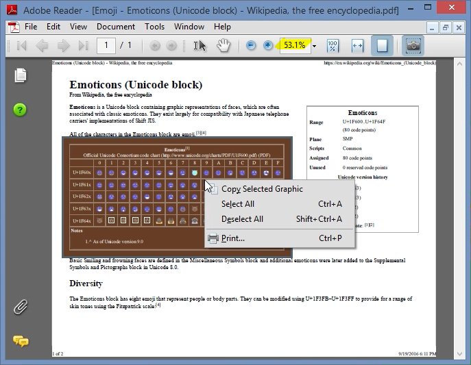

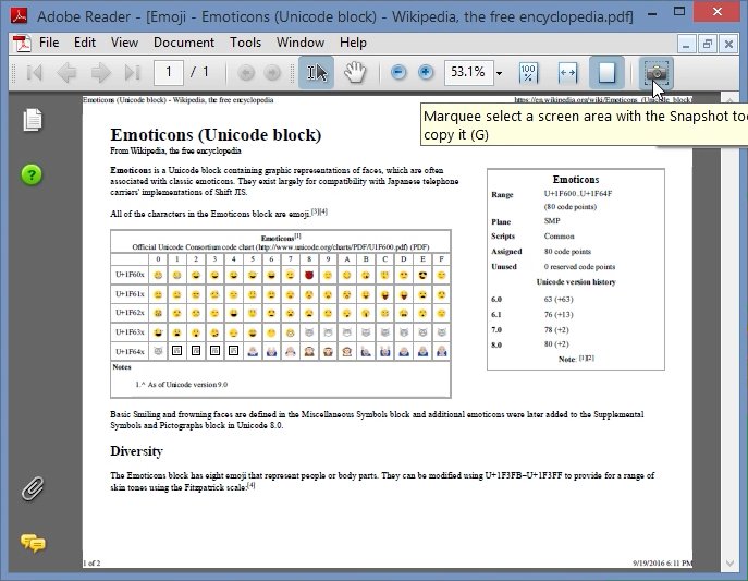

  5. Lots of image programs can import PDFs as vector art. You could export a series of bitmaps with increasing zoom...
    ...the simplest method though, would be to grab a HUGE bitmap from the PDF and zoom it in the editor:
    zoom PDF reader to full page.
    [Attachment 39640 - Click to enlarge]
    select the portion you want to show
    [Attachment 39641 - Click to enlarge]

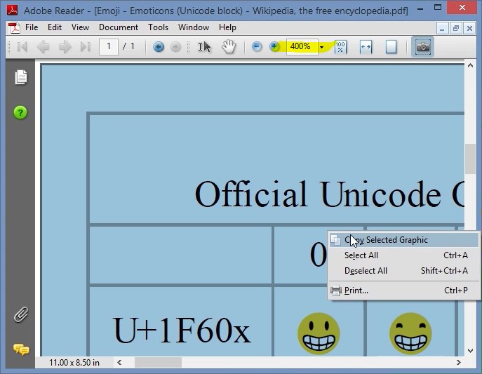

    zoom in to 200%, 400%, 1600% or whatever, right-click, copy
    [Attachment 39642 - Click to enlarge]

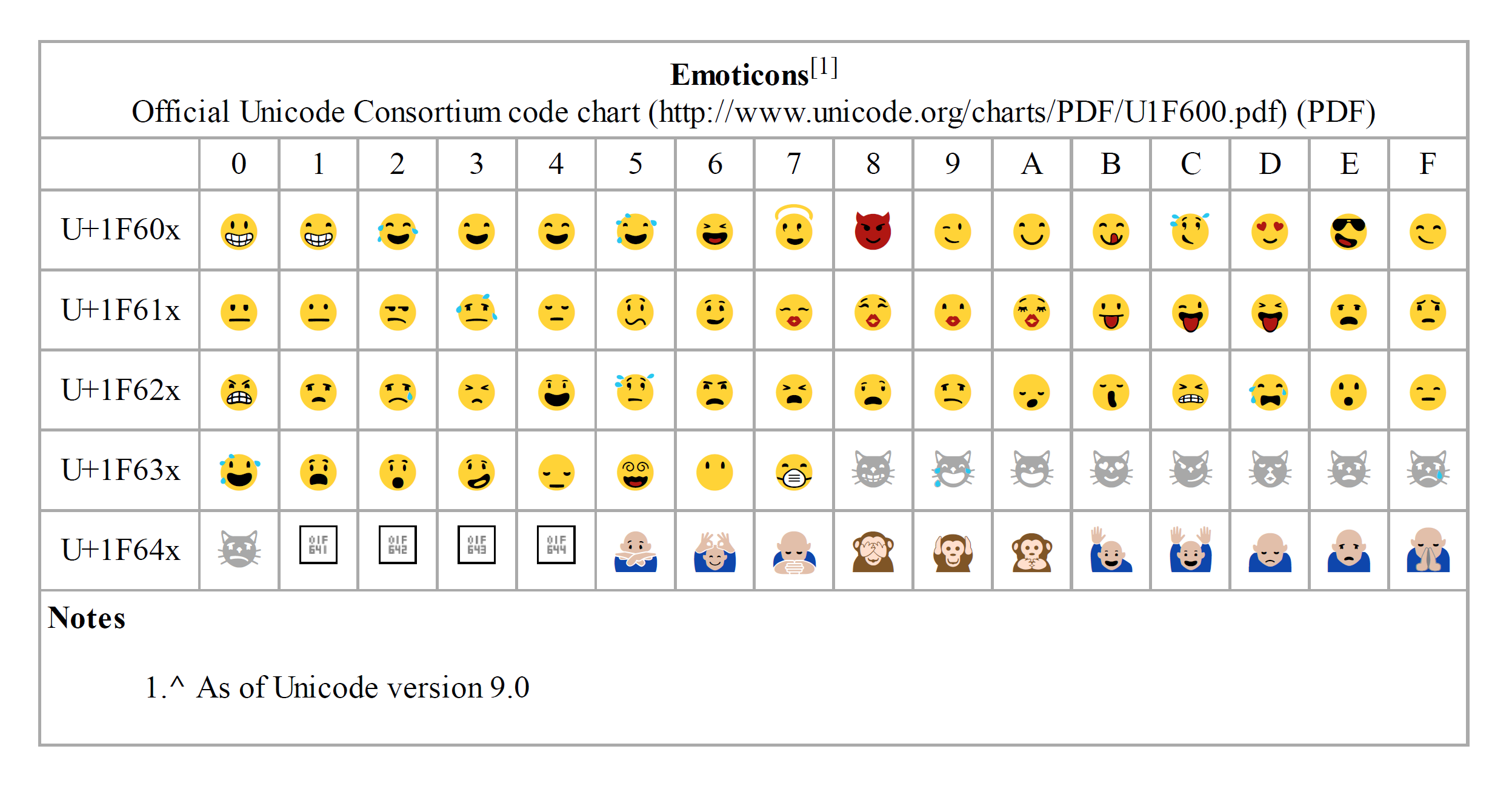

    You can go as big as your editor will allow.
    [Attachment 39643 - Click to enlarge]
