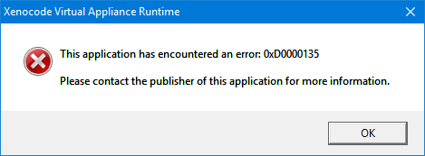

    I now have the accompanying BUP and IFO files in the same directory.
    Unfortunately, VOB2MPG doesn't run on Windows 10 x65 (build 14965).
    There are instructions on VOB2MPG's VideoHelp page under "More information and other downloads" which should correct that problem.
