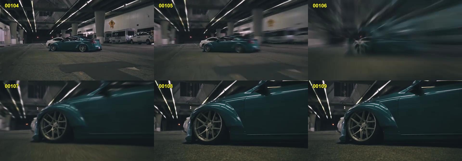

  4. He starts and ends slow (frames 105 and 107) with faster zooming in the middle (frame 106). All with frame blending enabled. Six consecutive frames:
    [Attachment 39611 - Click to enlarge]

  6. It's actually not as smooth as it should be, because there are duplicate frames every 5th frame. He produced it at 23.976, but the framerate is 29.97. (Probably not the guy's fault, probably instagram or whatver host botched the conversion) .

    I took a closer look and it's just scaling with motion blur (e.g in after effects) . The middle frame (frame 106 in jagabo's screenshot) is actually a center "hole" feathered mask cutout where the other layer is shown. But there are many ways can smooth that "highest velocity" frame over
    He's done it slightly differently with an off center zoom, by moving the axis. Roughly positioned on the front left tire - that is the scaling center, that's also why the blur stronger as you move peripherally from the tire. It's a nice way to draw attention to the FL tire transitioning into the B segement. The way I would do it is use the "transform" effect, with cc force motion blur, and just keyframe the values. Using the transform effect, instead of layer scale control means you don't have to precompose it, so all controls are available and exposed on the same layer, easier to tweak. Also using cc force motion blur, the controls are all tweakable and keyframeable, easier to control and adjust than using internal composition motion blur
    The zoom into B transition also has a mirror edge expansion, you can evidence of this in jagabo's frame 107 with the top edge bent border, but it's hidden slightly by the motion blur. In AE there is "motion tile", or "CC repetile" to expand and mirror the edges which is applied before the motion blur . Because you're zooming into, the scale prior is set lower at earlier frames, then to 100% when you've fully transitioned into B . Thus you will have black borders with a synthetic zoom
