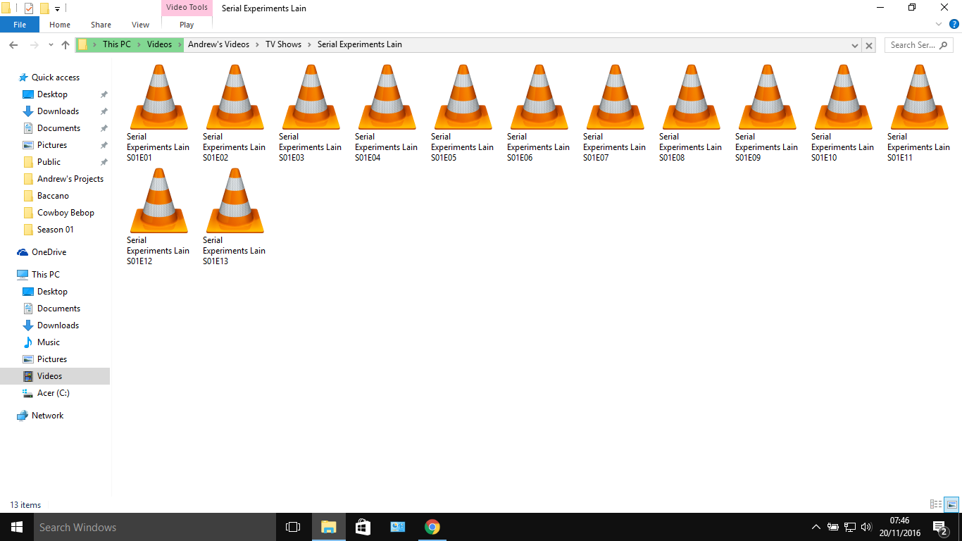

    Hi there, im a total noob to using ffmpeg im wondering if anyone can help me to write a script for a .bat file that will batch extract the audio tracks from all the video files in a folder.
    for example
    i also want to write a script that will take those audio files and batch join them to video files that are the named the same.
    for example if an video file was named "serial experiments lain S01E01" and the audio file was named the exact same the script would join both those files together.
    and it would do that for all the files in a folder.
    i want to do this without re encoding, just removing and re adding the files
