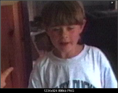

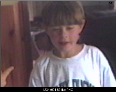

    Despite all the extra noise, I do notice more image detail in the highlights of the video I captured with the Canopus. You can see it in the white shirt below. When playing back the Canopus footage, as hard as I try, I can’t see any other advantages over the Digital8 footage. The noise is really distracting when it's playing and the Digital8 might even look a little sharper.
    I’m totally fine with processing the image in post. I just want to know that I’m pulling in the best image that I can using the Canopus.

    1) Sony Digital8 camera - no filters

    2) Hi8 Camera to Canopus ADVC 100 - no filters

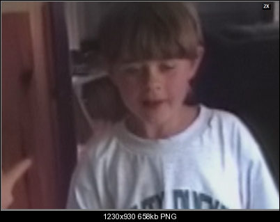

    3) Hi8 Camera to Canopus ADVC 100 - with Neat Video denoiser and a quick colour correction
