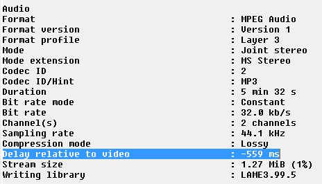

    There are several reasons, including the type of converter you use, that can alter the sync. Hopefully you just alter the sync during muxing if you can. First you should look at the failed MKV and make sure you do not see any offset in the audio which players use to display correctly but which may not be translated during conversion:

    I'm not famliar with TSmuxer much so maybe others can add more help in this area.
  3. Ok so you are saying that even tho the mkv plays flawlessly I should check there is no delay in it that the software might be correcting while playing . How do I look at that info you posted for my mkv? Sorry. I just assumed it was after conversion or during that a problem occurred.
  4. Sorry for the double post but I think I need mkvtoolnix is that right? Can anyone else she'd some light please. Thanks .
  5. Check the MKV for a negative audio delay with MediaInfo (a per Budman1's example). There's no such thing as a negative delay for MKVs so a negative audio delay means there's really a positive video delay. I'd recommend opening the MKV with gMKVExtractGUI, now I think about it. It requires MKVToolnix. You don't have to extract anything, but gMKVExtractGUI will show you both the audio and video delay, which might indicate that's the problem. When it extracts, gMKVExtractGUI assumes there's no video delay so it adjusts the audio delay compensate before writing the delay to the file name.

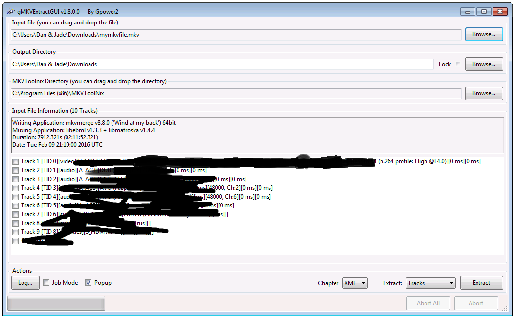

  6. Ok heres a screen of gmkv i took and as far as my meagre skills can see every aspect has a 0ms delay.

  7. Try setting an appropriate audio delay in TSMuxer when you remux. It can be positive or negative, depending on the direction you need to shift it. If that solves the problem it'll be easier than spending a lot of time trying to work out the cause first, because you're probably still going to have to fix the sync by applying a delay anyway.
    Hopefully doing so will sync it again from start to finish. If you can sync the audio at the beginning by applying a delay, but it wanders out slightly as the video progresses..... well..... one problem at a time.....
