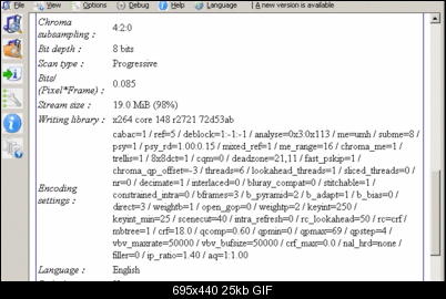

  2. The x264 encoder has a single pass, quality based encoding mode. That's what most of us use. The encode is roughly the same quality relative to the source each time (for a given CRF value and identical encoder settings) while the bitrate varies accordingly. It also has an average bitrate encoding mode which will output the same file size for a given duration each time, which is less efficient, but MCEBuddy could be using that. I don't use MCEBuddy although I'd forgotten about it so I'm going to download it for a look. If I can work out the settings it uses I'll report back, unless someone else knows.
    I had a quick scan through the documentation but I couldn't find any details regarding the encoder settings. If it's using the x264 encoder for h264 encoding, which it probably is, and the encoder is writing the settings to the video stream, you can see the details with MediaInfo (use the Text or HTML view). You can paste them here if they don't mean anything to you. They should look like this with MediaInfo displaying in HTML view.
    Keep in mind if you take a high quality source and encode it at 12.66Mbps (for example), then encode it again at 4.92Mbps, then re-encode each of those with a quality based encoding method, there's no guarantee the re-encode of the 4.92Mbps source will result in a lower bitrate than re-encoding the 12.66Mbps source. In fact if the 4.92Mbps source has more compression artefacts due to the lower bitrate, that can make it harder to re-compress and require a higher bitrate.
    The amount of motion, picture detail, noise, and grain etc all play a part in how hard a source is to re-compress. The source bitrate doesn't necessarily reflect those things. If the file size is already on the low side, it's possibly not worth re-encoding.

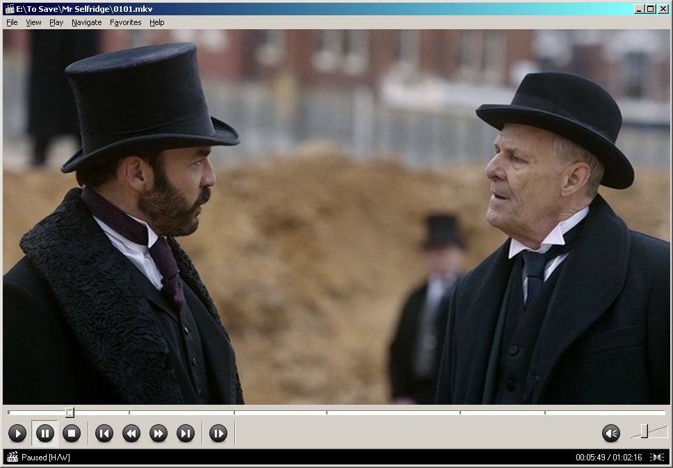

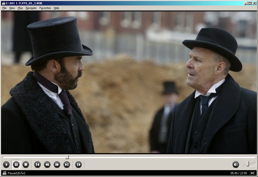

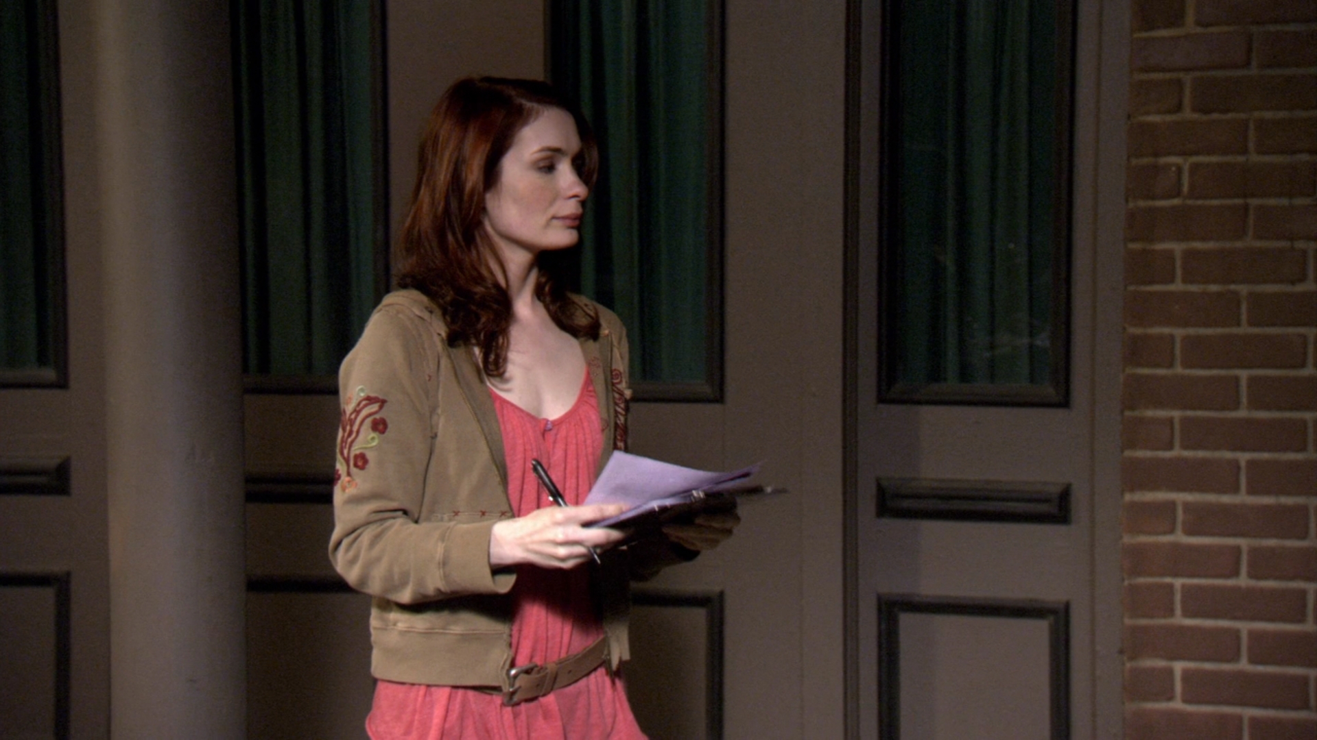

    A few screenshots from an old post that were easy to find. Even if it's only a subtle improvement, which it usually is at best, it's still better than a subtle loss of quality.
    Original DVD:
    https://forum.videohelp.com/attachment.php?attachmentid=30871&d=1427391802
    Encode:
    https://forum.videohelp.com/attachment.php?attachmentid=30872&d=1427391921
    Original 1080p:
    https://forum.videohelp.com/attachment.php?attachmentid=32838&d=1437985152
    Encode:
    https://forum.videohelp.com/attachment.php?attachmentid=32837&d=1437984916

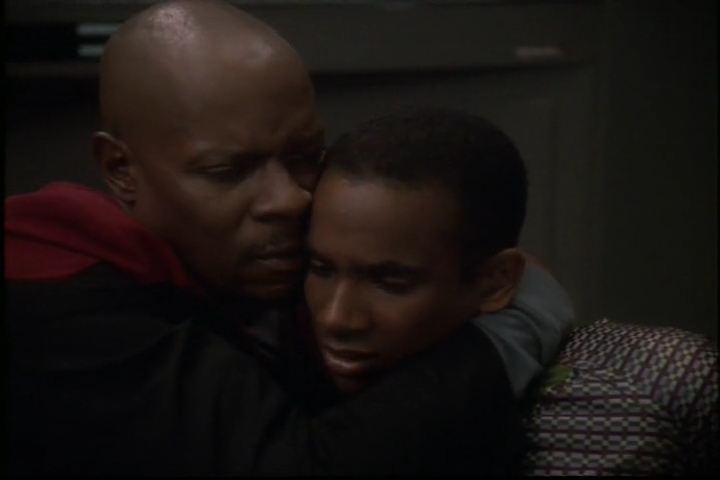

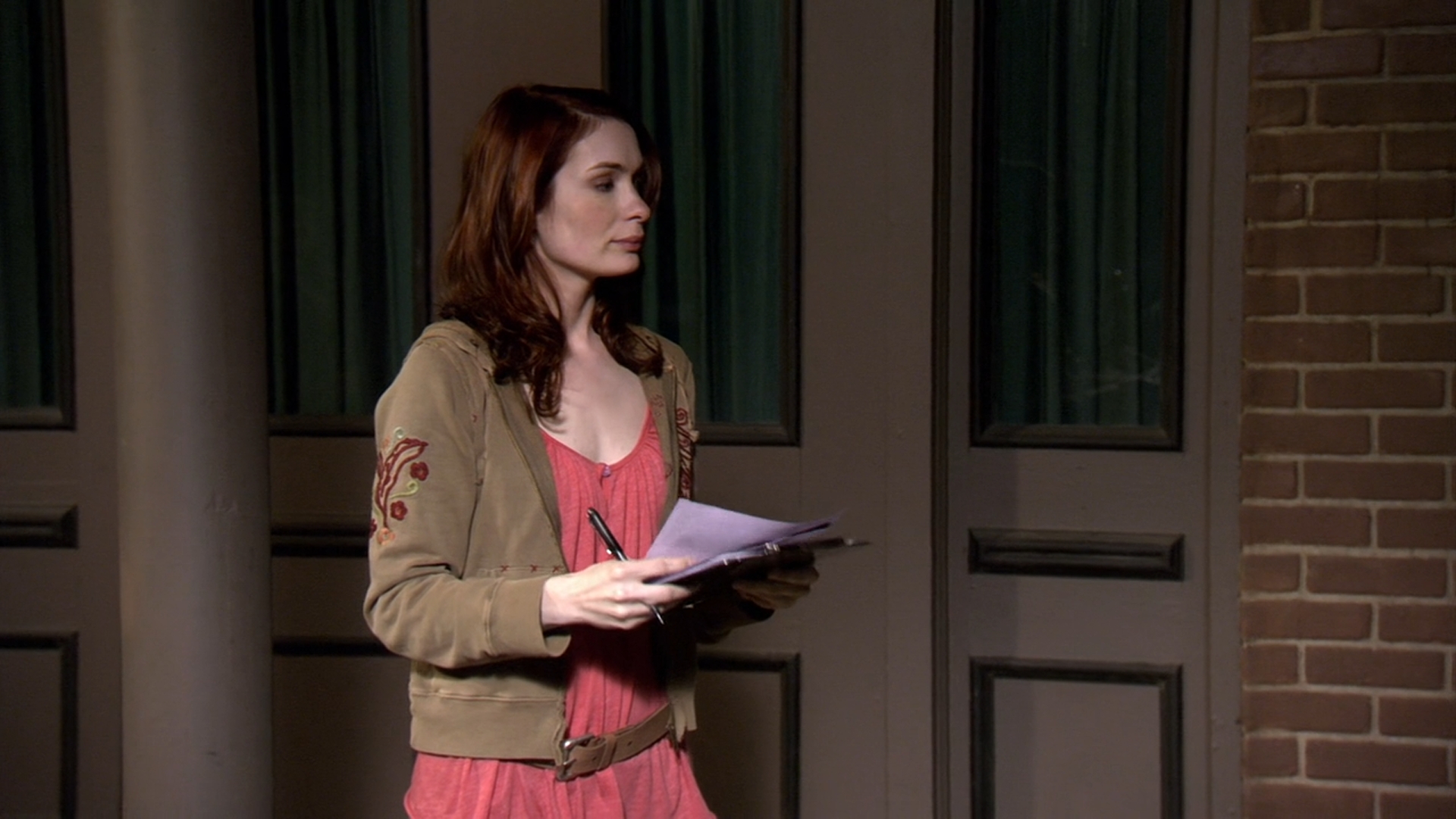

  11. I ran a couple of CRF vs CQ (constant quantiser) encodes for a comparison today and the differences weren't nearly as great as I'd expected, but then again I've never compared them before.
    The source was a 720x480 video, about 45 minutes in duration. Reasonably noisy as it turned out (I picked a random episode without looking at it) and encoded with the default x264 settings aside from "tune film" as I normally use it. No resizing or filtering, just a straight re-encode.
    CRF18 - 505.2 MB
    CQ18 - 508.9 MB
    CRF23 - 208.1 MB
    CQ23 - 218.4 MB
    I thought to compare them properly I might have to run the CQ encodes, note the bitrates and use them for some 2 pass encodes (which encodes the same way as CRF) because the only way to judge if an encoder or setting etc is better than another encoder or setting is to compare encodes at exactly the same bitrate, but given the bitrates for the CQ and CRF encodes were so similar I didn't bother with 2 pass encodes.
    At CRF18, for this particular source at least, I couldn't reliably say which looked better or even which method encoded more accurately compared to the source, and I was pausing each on identical frames for a good nitpick. CRF18 and CQ18 appeared to have encoded most frames just a little differently, but I gave up trying to decide if one method was better on average.
    At CRF23, which is lower quality than I'd normally use (I picked it as it's the default quality), I still thought much the same thing much of the time, although CRF did seem to be a little more accurate and retain a little more detail than CQ on average, but just as I was starting to wonder if there was all that much advantage to CRF encoding I found a few frames like this. I don't know how much different they'll look at their native resolution (and displaying on my CRT monitor they don't look much different at all) but upscaled to 1080p on the TV it's easy to see the CRF encode retained more detail.
    Source
    [Attachment 39743 - Click to enlarge]
    CQ23
    [Attachment 39744 - Click to enlarge]
    CRF23
    [Attachment 39745 - Click to enlarge]
    I went back and checked the same frames for the CQ/CRF18 encodes and although the difference between CRF and CQ was far less, CRF definitely kept a little more detail.

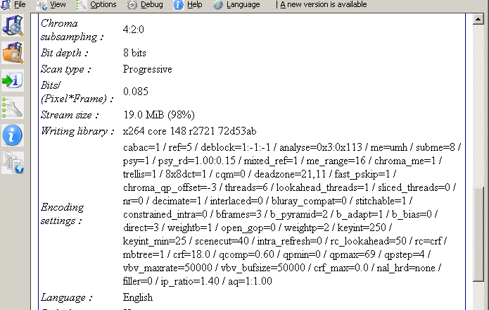

  13. Handbrake uses crf. You can use MediaInfo to examine a file with x264 and see all the settings that were used.
    The difference in size when using qp vs crf varies depending on the particular video.
