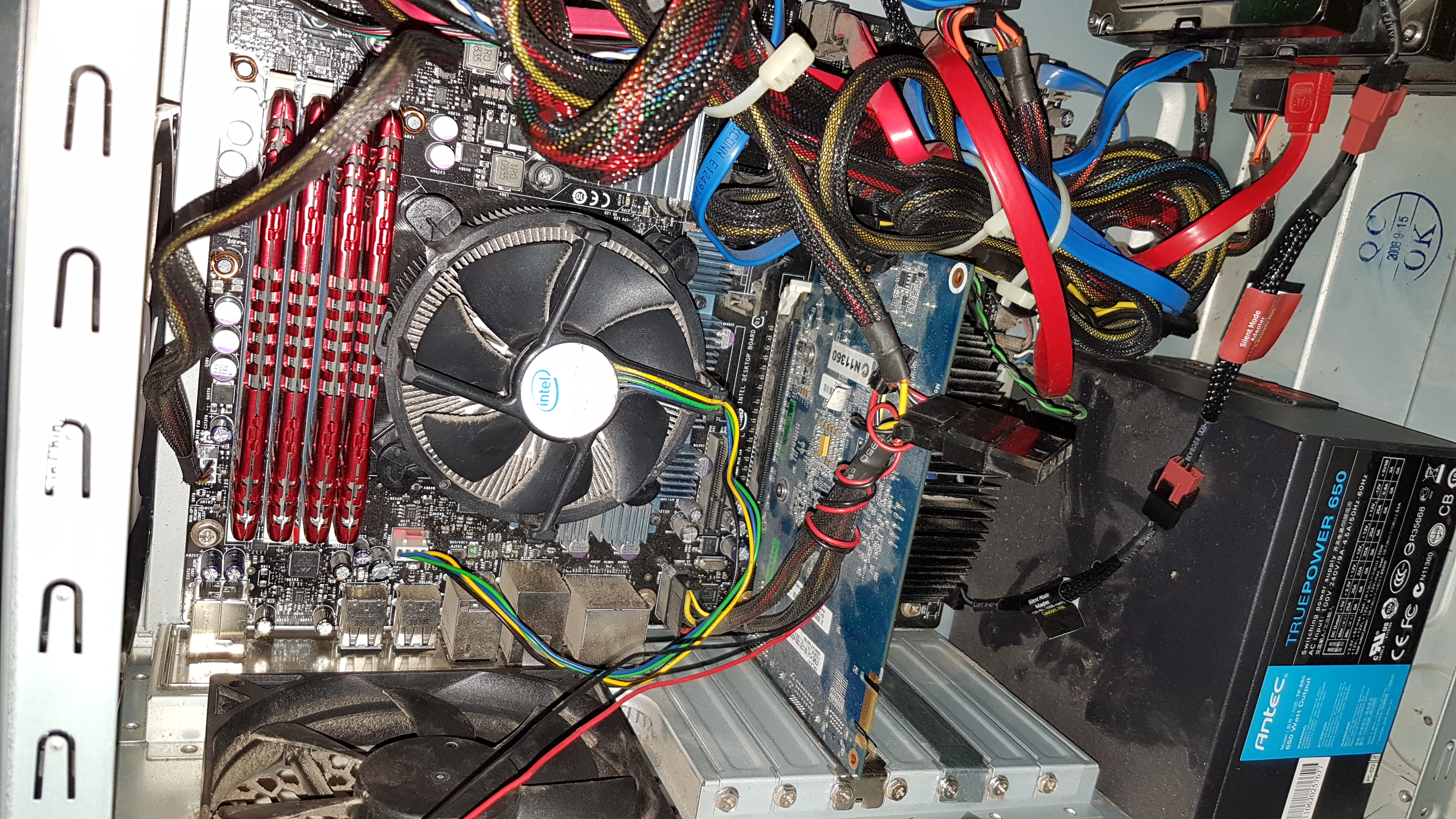

    Attaching a picture of the inside of my case. Not really sure how the heatsink goes in, so what exact space I'll need.
Name:	2016-12-21 11.34.57.jpg

  8. That's a awful lot of dust in the heat sink. You need to clean that out. See if core temps improve.
    Check the dimensions of the HS you plan on getting and see if it looks like it will fit in the CPU area. The memory chips are very close to HS. That might be a problem.

  10. Get a can of compressed air and a clean small paintbrush, take it outside and blow the bejeesus out of it, use the brush to dislodge chunks, and then do it again. This would be for the CPU heatsink, you know, the one with the problem. Clean all fans and inlet/outlet holes, power supply, etc. Blow baby blow.
    Power supply does not appear to have a case exhaust fan. Highly recommended.
    Put the fan on the side of the case, the one blowing right at the CPU, back on.
    Dust filters can be made with fine panty hose and thin sheet of open cell foam for exterior of case. Panty hose on both sides of filter. Remove and wash regularly, dry thoroughly before replacing.
    Absolutely no freaking way you should be seeing those temps, even with the dust. Finally doing a simple test with temps is absolute verification. Very high probability there is TOO MUCH heatsink paste. Layer should be extremely thin. Use dab about one-half a grain of rice. Also possibility the clamps are not on correctly. Verify carefully, those are easy to get wrong, also easy to tell by feel that pressure is correct. High odds one or more is loose. Remove, clean THOROUGHLY, reapply paste, replace is quick and easy.
    Emphasize that SOMETHING is very, very wrong with the heatsink installation. If for not other reason, this should be re-done so you know how to do it in the future. Absolutely, positively this one is not done correctly. Getting those temps with a simple file copy is not right.
    Do NOT run without heatsink. CPU will get hot enough to put a blister on your finger within 3 seconds of power up. Personally verified.
    More fans can go slower and make less noise. Filters help with noise. Removal of dust critical to keep fan speeds low. Too much paste is most common error. Need exhaust at a high point of case to remove hot air. Only quiet way to go is water cooling, though if you get the fans right, sink clean, right amount of paste, external air to CPU and hot case air removed, plus filters, noise should not be too bad.
    It would be useful to know what CPU temps were being reached, under specific usage cases, BEFORE the heatsink was removed and replaced the first time. Near certainty the temps were not this high, which would translate to a near-certainty the heatsink was installed incorrectly. This is not my first rodeo, which is why I know the reason that info has not been given, and also why I have been fairly sure from early on that user error is and has been the sole cause of problem.

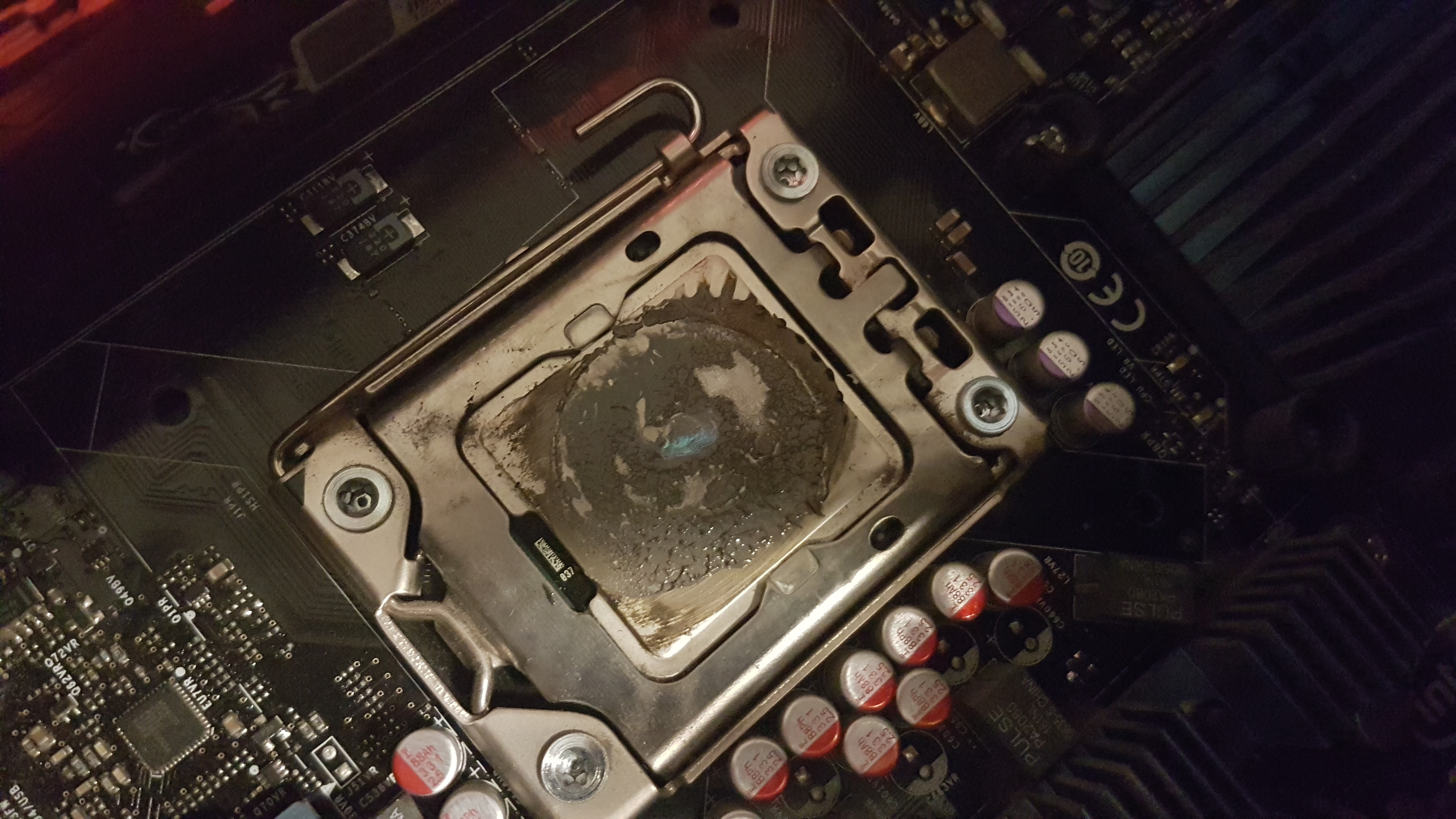

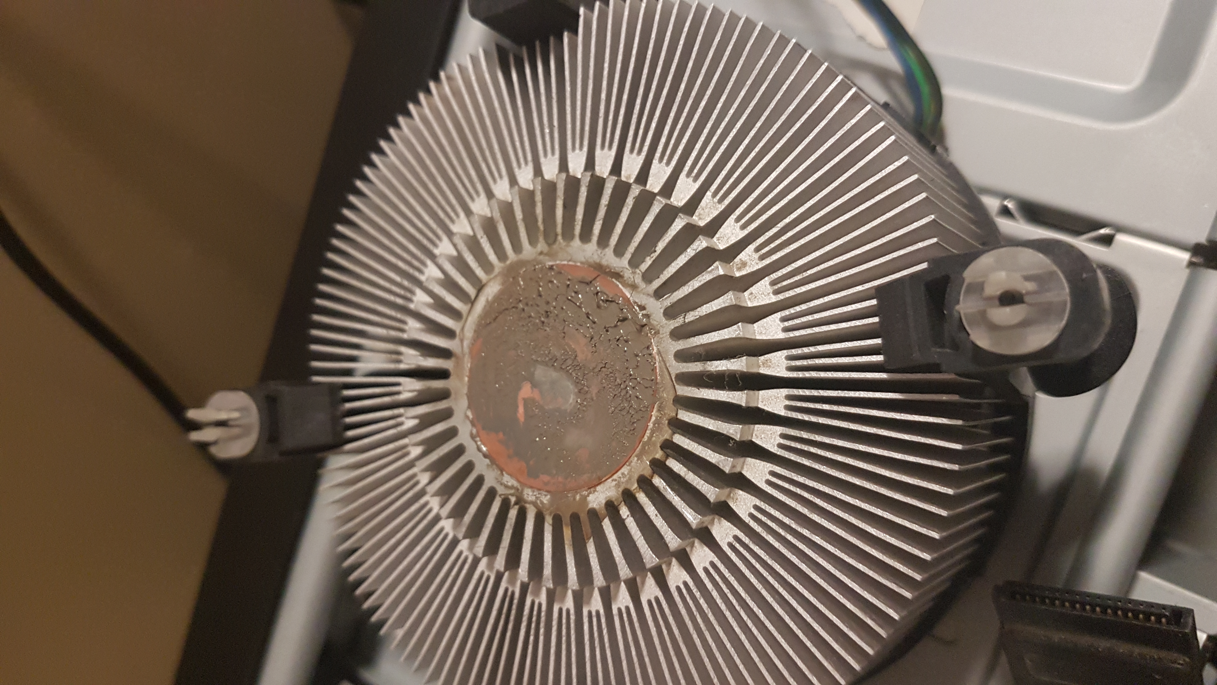

  15. Yeah, I don't think this looks right.
    EDIT: Found this while trying to figure out what measurements I'd need to find out if it'd fit....what's the 'memory clearance' mentioned?

  16. A truly massive ****up on the heatsink paste. MUCH more than is required. A bead about half a grain of rice is all you need. CLEAN ALL SURFACES CAREFULLY AND THOROUGHLY FIRST.
