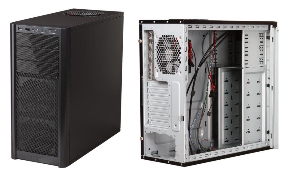

  10. Pictures of the Antec Three Hundred show drive bays at the front of the case. And two grills with fan mounting holes right in front of them.
    [Attachment 39941 - Click to enlarge]
    You can move the fan from the top of the case to the bottom front fan mount, and relocate the drives down there (if they're not already there). But have that fan blow air into the case rather than out. That gives you air flow from the bottom front of the case, over the fans and motherboard, then out the top back of the case. Of, if you want really good cooling, keep the fans you have at the top and rear, and add two more at the front blowing in.
    Case fans usually have mounting holes that allow you to install them either way, air in or air out. And there's usually an arrow on one side of the fan that indicates which direction it blows.
    I seal off grills I don't want air passing through with duck tape.
    Ah. The front cover on mine is nowhere near that see-through.
    I can't; it's too big.
    There are two arrows. As the fan was configured before I removed it, one pointed up out of the top of the case, the other pointed out towards the open side of the case. Not sure what the second is for.
    I think it varies from one country to another whether duck tape is a misunderstanding of duct tape or a different thing, and even what duct tape is. Shiny, plasticky silver stuff? Or a black, more fabric-textured thing?
    Given the top fan was spinning when I had temps in the mid-high 90s, and that my CPU is likely to DIAF at those temperatures, though...would you expect this to help much?

    Well, the top fan doesn't fit in the front anyway so I might as well leave it in the top. I assume I should cover the hole in the side though.
    What should I buy to put in the front? Is it worth getting a new heatsink? Would it fit? How worried should I be about the processor? If I end up ordering parts online, I'd rather only pay one lot of shipping.
  14. Ah, I see, the top fan is 140mm whereas the others are probably 120mm. Then just add a 120mm (if that's the correct size) fan at the front.
    That case is pretty big. It should be able to handle a heat sink like the one I linked to. Look for a heat sink where the heat pipes touch the CPU -- that gives better cooling. Some just run the pipes through a block at the base.
    Get the cooling worked out first. Then test your current CPU. It may not need replacing. Make sure your power supply is big enough to handle everything, including all those external USB drives.

    Okay, so. Installed two fans at the front, in addition to the top and back fans, and covered the hole in the side of the case. Front fans going in, top fan going out. I don't know which way the back fan goes; it doesn't have any arrows on it anywhere.
    Per SpeedFan: Fan1 2599, Fan2 686, Fan3 2047, Fan4 1148.
    GPU 39, CPU -35, Internal 43, Temp3 51, Temp4 59, HD1 35, Cores: 60, 66, 60. So...still hot, and I seem to have lost a core somewhere.
