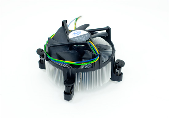

    Could heat be an issue? It's summer here, and we've had a few really hot days recently and I had zero issues with this MeGUI process the five times I ran it a couple of weeks ago. I do remember having this issue a handful of times last summer.
  14. Originally Posted by koberulz View Post
    There's obviously something wrong with your computer. Overheating could definitely be an issue. Use a program like CoreTemp to monitor your CPU temps.

  16. ~80 degrees is pretty hot though I think it's within spec for an i7. Still, I'd check the CPU fan and heat sink. Make sure the fan is spinning properly and the heat sink isn't clogged with dust.
  17. Fan seems fine, temps pop up to the mid-80s intermittently when encoding through MeGUI.

  19. With the CPU at 80 degrees your case temperature is going to be high too. That could cause failures of other components. Get better/more case fans.
    Just FYI: I have a i5 2500K and rarely get temperatures over 60 degrees (usually about 50 degrees under load). And I'm set up for quiet running, not low temps.

    If you are putting "fan seems fine" and "CPU temps spike into 80C range", there is something very, very seriously wrong with your definition of "fine".
    The question was whether it was spinning properly. It looks like it's spinning properly.
    FWIW I re-did the thermal paste under the heat sink about a year ago.
    Use something like SpeedFan (or the BIOS hardware monitor) to check fan speeds.
    Make sure the heat sink is still securely attached. If the clip has come loose at a corner it won't be making good contact.

    Well, I can report two things: firstly, temperatures in the high eighties to mid nineties when doing the second pass of an encode, so clearly temperature issues. Secondly, success with an encode, finally, so that should release the pressure until there's something else I want to commit to disc. Which hopefully takes a while.
    I don't really know my way around the BIOS, or what I'm looking for in SpeedFan. I'm seeing Fan1 971 RPM, Fan2 and Fan3 0 RPM, Fan4 646 RPM. Fan1 just popped up over 1000 briefly, didn't catch the number.
    AFAIK Fan2 and Fan3 don't exist as fans, merely motherboard spots for fans.
    I'll check that when I shut down.
    Run memory diagnostics. Run CPU stress utilities while monitoring CPU temps, fan speeds, etc.
    What should I use for this step?
  26. SO, the fan is actually turning in circles, eh? Clearly no possibility of problem there, then. Good thing you looked at it.
    I asked specific questions for specific reasons, but I see you are intent on actually destroying the hardware, so, have fun with that.
    I have predicted the future, I no longer give a crap.
    High odds you massively effed up the heat sink paste, though. Interesting but with virtually zero possibility of useful information forthcoming I'll likely go watch the grass grow.
    That's really hot. It may not be your only problem but it's certainly something that needs fixing. And it's the first thing you need to fix. Any time a computer locks up or crashes under load you are at risk of corrupting drives, burning out hardware, etc. In a worst case scenario you could fry the power supply, motherboard, CPU, memory, drives, etc. This is why you should be using the computer as little as possible until the overheating is fixed.

    I'm seeing Fan1 971 RPM... Fan4 646 RPM.
    Those speeds are probably OK (depending on the particular fans) for a computer at idle. You should see them increase under load. If not, you need to figure out why. There's usually a BIOS setting that controls this.
    It wasn't even your question, and it was answered as specifically as it was asked.

  30. You need to figure out which fans are being monitored. One way to do this is to run the computer with the case open and the case fans disconnected. Does speedfan still show any fans spinning?
    So you have two case fans? A heat sink fan, and a power supply fan? The power supply fan usually isn't monitored but some power supplies include leads for monitoring. Are you using the stock heat sink and fan that came with the CPU? Those usually look something like this (older ones may look different):
    [Attachment 39930 - Click to enlarge]
    Those are usually adequate if you have sufficient case cooling. And they include monitoring when plugged into a motherboard fan connector. I usually use larger heat sinks with heatpipes (better cooling and quieter):
    http://www.newegg.com/Product/Product.aspx?Item=N82E16835103099
    But a cooler like that might not fit in your case.
