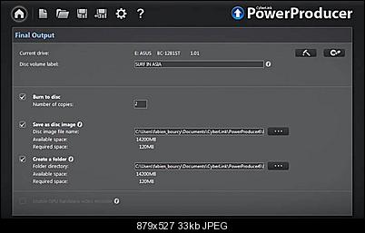

    Aug 2006
    You need to uncheck "burn to disk" and check one of the other two options (whichever you want) to burn with another program, such as ImgBurn.

    When PowerProducer is finished creating the Blu-ray files and folders or the disc image, open ImgBurn itself. Follow the guide sneaker posted for burning files and folders. Burning a disc image requires selecting "Write Image File to Disc" on the first screen in the guide, and opening the image file in the next screen.
