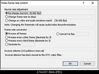

  3. I tried DirectStream, but apparently it does not supports avi files.
    Is it possible to change the Full Processing Mode setting so it will smaller file?
    I check the Frame Rate setting...seems to me they are ok. Isn't it?
