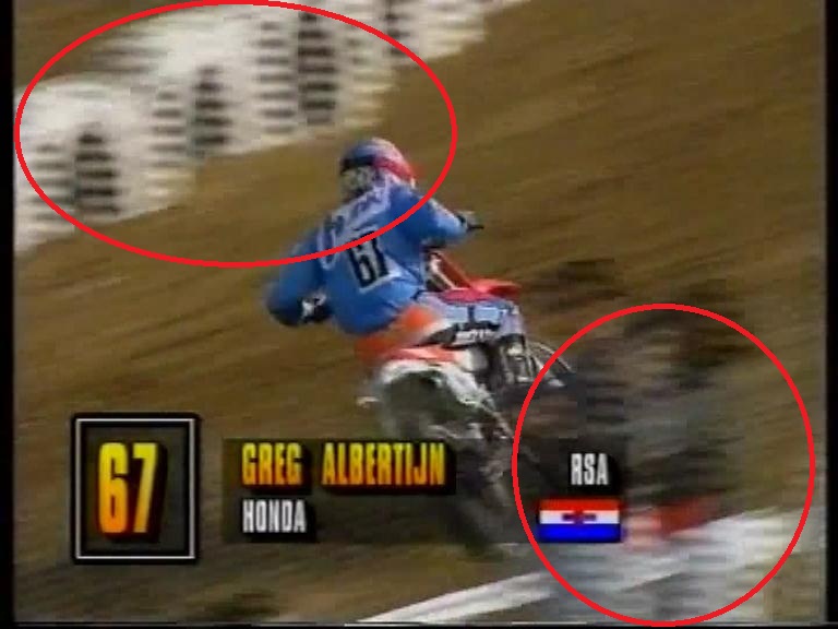

    Why I getting this trashes lines on DVD compilation, on movment scenes?

  3. The video was once interlaced and has been mishandled.
  4. You really should start a new thread for each of your videos because they each are quite different.
    The problem in this one is caused by someone (you?) re-sizing an interlaced video without first deinterlacing it. This is an extremely common problem. It cannot be undone, although I did work with some other people to come up with a "solution" that can make the video look a little better:
    repair bad video
    The OP in that thread thought it was caused by deinterlacing, but he was wrong.

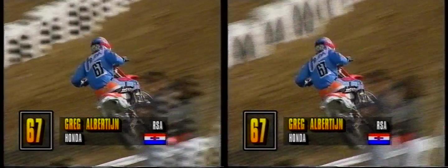

  6. Many of the videos you've uploaded have the same problem. It's just that some of them were otherwise so badly mangled it was hard to see. They started life as 720x576 interlaced frames. Someone resized them to 720x540 and encoded them as progressive without taking into account they were interlaced. That has caused the two fields to partially blur together. They can no longer be separated. That is why I suggested you forget trying to smart bob them and just use vInverse() to blend the two fields together.
    https://forum.videohelp.com/threads/381174-Best-Code-to-Improve-this-Garbage?p=2465717&...=1#post2465717
    QTGMC on the left vInverse on the right:
    [Attachment 39705 - Click to enlarge]
    Thank you master!
    I do apply all this?
    LSMASHVideoSource("1999_AMA_250_SX_PAL.mp4")
    vinverse() # blend comb artifacts
    BilinearResize(width/2, height) # downsize, clean edges, upsize, sharpen
    Sharpen(0.3, 0.0)
    Santiag()
    Spline36Resize(width*2, height)
    Sharpen(0.2, 0.0)
  11. Apply whatever is necessary to get the look you want. Everything after vinverse() in that script was to smooth out some artifacts and sharpen the picture a bit.
