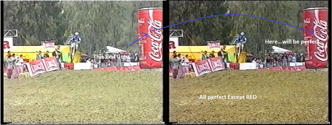

    Originally Posted by LMotlow View Post
    More difficult question: What the hell do the makers of these videos think they're looking at? Or they've found ingenious new ways to screw up YUV color. Maybe it's a new fad.
    Originally not so to bad I believe, but was spoiled by a number of wrong procedures of capture conversion and copying...

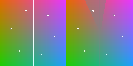

  26. Tweak(sat=0.50, StartHue=80, EndHue=115,coring=false)
    Be careful when using Tweak like that. It creates discontinuities when there are smooth gradients. Before and after:
    [Attachment 39667 - Click to enlarge]
  27. Member Caiosouza's Avatar
    Nov 2013
    Capćo da Canoa, RS, Brazil
    Like this?
Name:	frame 531 original -vs- correction.jpg
  28. I think so. I'd have to see the source too to say for sure.
  29. Member Caiosouza's Avatar
    Nov 2013
    Source video do not contain this.
    This firts tweak not cause This probelm, but kill the red...
    Tweak(hue=12, sat=0.95, dither=true, coring=false)
    The problem is a minimal alteration....and cause a high "Storm" in the colors....
    This firts tweak not cause This problem, but kill the red...
    Not so. The line "Tweak(hue=12, sat=0.95, dither=true, coring=false)" increases red and reduces green. Positive values for Tweak() move the colors toward red. Read up on the link to the Tweak() function and see for yourself.
    You'll never correct all of the color in that video. YUV channels were corrupted a long time ago. They'll never be the same again. Perhaps you could try some color blend modes and adjustment layers in AfterEffects or Premiere Pro to experiment with possibilities. Color in that video is ruined, along with a lot of elements. Probably better to let it stay as-is.
