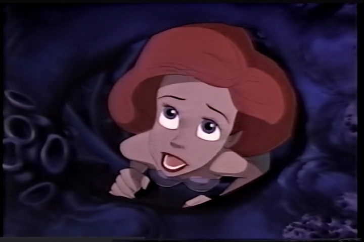

    So to survey how much damage to the original source this method does, I encoded a noiseless animation clip from crf18 to crf30 and Merged them together. As expected, moving objects were a little flawed. With objective metrics, the Merged clip was rated better quality than the best of the encoded clips. Better quality than crf18 despite it being the average of clips as high as crf30.
    That's the part I found interesting. How does introducing 10 crappier quality clips into the equation increase the quality of the best one in the mix? Does this defeat the common wisdom of Shannon's theorem or the proverbial "garbage in, garbage out"?

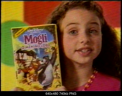

    Source frame:

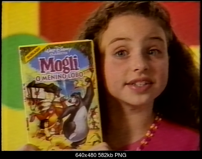

    MCTD result:

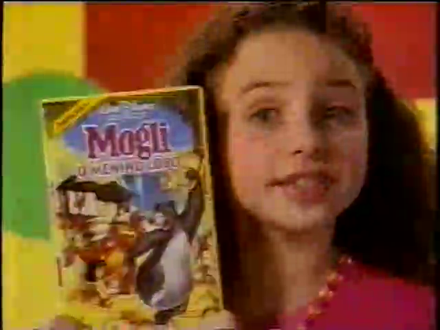

    The individual cqp=16 result looked much the same as the original, the cqp=44 result looked very bad, and the others between those extremes. Here's the cqp=44 result:

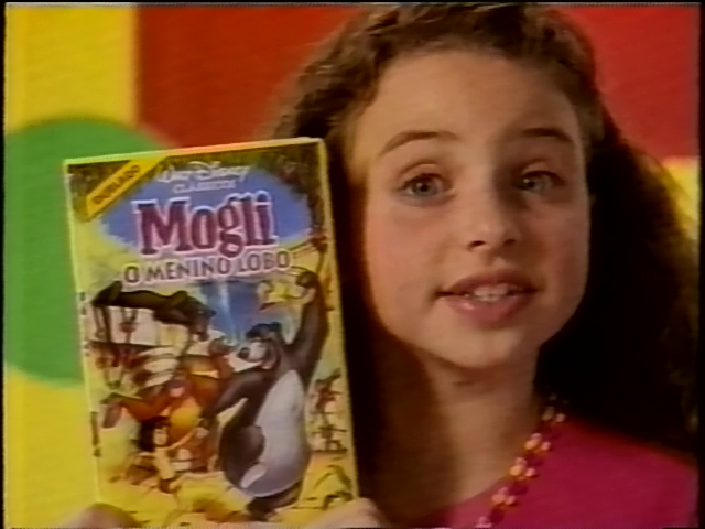

    And the final merged QSVEnc result:
    MCTD gave a better result (less noise, more detail, sharper). But the merged QSVEnc result is surprisingly good.
    My conclusion is that using a real noise reduction filter is superior than merging the results of several h.264 encodings. But the latter technique is interesting.
