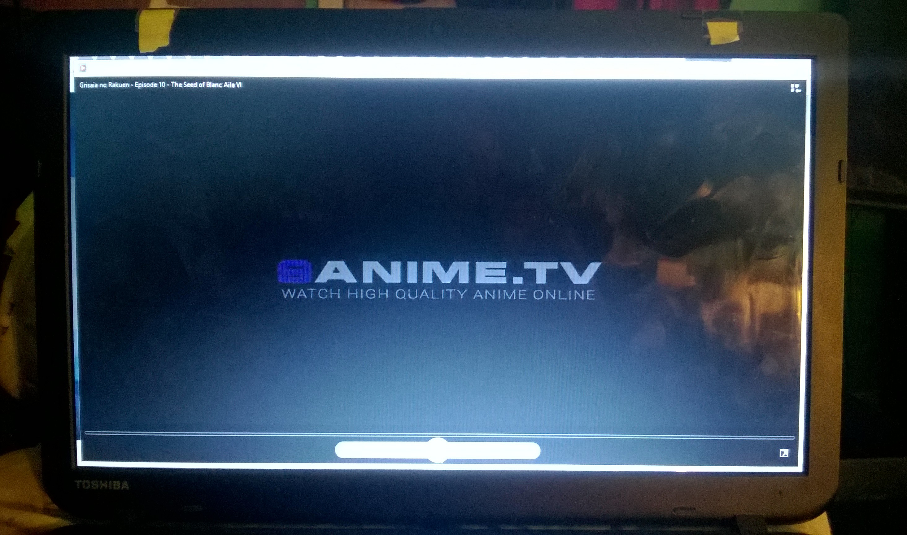

    Is it possible to have two Mp4 files, both that in the properties have the Width x Height that is the same
    of 1280 x 720 and yet when they are open, one is clearly much wider than the other and close to 1350x738?
    Any information would be appreciated. I am aware it might be to do with the original file's aspect ratio
    yet I still do not quite follow. They both are supposed to be the same size (width x height) yet they clearly
    and visibly do not.

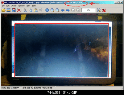

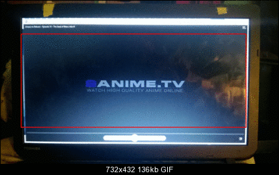

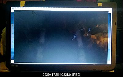

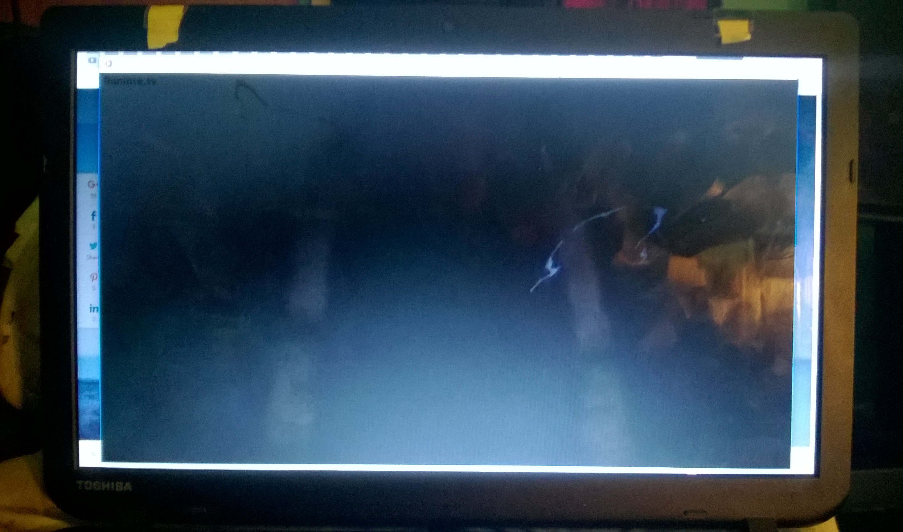

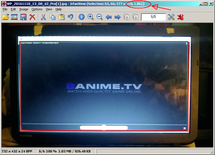

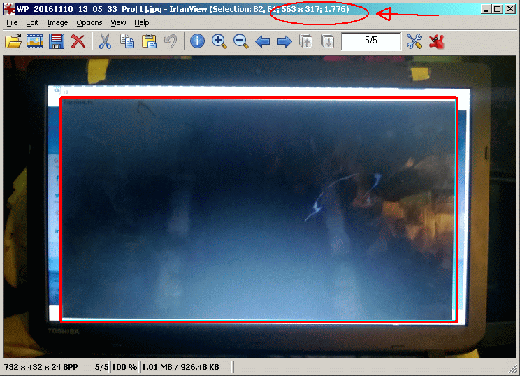

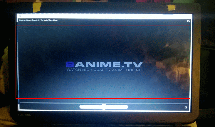

    I have included two pictures to show what I mean, one is the first file I converted which originally was
    1280x720 and the second is the next file I converted which originally was 1280x544.
    As you can see, there is clearly more space either side of the first video than the factual second yet
    they both apparently are the exact same 1280x720 width x height.
    Any information would be appreciated and my gratitude in advance for anyone who views this and
    can explain how come this is. I am not a novice when concerns conversions and media files or even
    using a computer as I spend my near entire day doing work on my factual laptop, yet this fact
    escapes my understanding slightly.

    It would indeed be possible, yet strange. HD resolutions usually have "square pixels" (SAR 1:1), except for some anamorphic AVCHD formats. So having a 720p video with an additional skewing factor is not so usual. But let's compare MediaInfo reports of both videos...

    Someone produced a skewed video here. It looks like "Academy format"; on a DVD Video, it would probably have had a black border all around.
    Such things happen when someone cropped the video out of the border to avoid encoding void black. But expanding it to a usual format would stretch the content more in one direction than in the other (= "anamorphic"). That may be hard to recognize for small differences if a player doesn't care about such skewing flags and simply displays the stretched video. But if a player does care about such flags, it will deskew the video, and the resulting aspect ratio is not the same as the one of your screen.

    Not all videos in this world have a 16:9 display aspect ratio. Cinemas have a much wider canvas than the usual PC monitor. It's a fact you will have to accept: Often there will be unused space, either encoded in the video as black bars or not encoded and left outside a smaller player window.
  9. Any frame size can be used for any display aspect ratio. The display aspect ratio is calculated with:
    DAR = FAR * SAR
    DAR is the display aspect ratio, the final shape of the picture
    FAR is the frame aspect ratio, the relative dimensions of the frame
    SAR is the sampling aspect ratio the relative distance between pixels on the X and Y axis
    DAR = FAR * SAR

    The aspect ratio was exactly the issue. The equation I gave is universal. It works for all digital video. Sometimes the final display aspect ratio is indicated directly in the file, ie "display the picture with this aspect ratio regardless of the frame size". Other times it is indicated by the frame size and the sampling aspect ratio, and it's up to the player to calculate the final display aspect ratio.

  16. Originally Posted by Greyback23 View Post
    The aspect ratio and information or flag differs so the shape will never match, yet
    the information of both files will still state that they both are 1280x720?
    They both store the image as 1280 pixels wide and 720 pixels high. But one says to display that frame with a 1.78:1 (16:9) display aspect ratio. The other says to display it with a 1.85:1 aspect ratio.
    Another thing to note is that not all players will respect aspect ratio flags. Most software players in Windows do. But the media players built into some TVs do not. They may automatically scale every video to fill the screen. Or they may assume the display aspect ratio is the same as the frame aspect ratio. And this behavior might vary depending on whether the file is MPG, MP4, MKV, AVI, etc.

  18. The word "factual" has lost all it's meaning for me. Now it's annoying.
    I'm not sure you understand the problem fully, and I assume your laptop screen is exactly 16:9 and not a slightly different aspect ratio?
    The player seems to be resizing so the video fills as much of the screen as possible, but the gaps doen the side don't necessarily mean anything is wrong.
    Part of your problem seems to be caused by the video being prevented from filling the entire screen.
    It appears your first screen shot is 1280x720, 16:9 video (1.777:1), assuming the red rectangle I've drawn represents the entire picture, in which case it's displaying with the correct display aspect ratio.
    What's taking up room at the top of the screen? Is it part of the picture? If it's not (player menu or window etc) then the 16:9 video is displaying correctly. The picture itself isn't filling the entire height of the screen, so there has to be gaps down each side to keep it 16:9. The wider the picture, the less gaps there'd be at the sides, so....
    1.85 is wider than 1.77, therefore when the width fills the screen there'll be gaps top and bottom. In your case whatever is limiting the height of the video is preventing it from resizing enough to fill the entire width, but it's pretty close.
    The 1280x720 resolution is irrelevant because as you've shown, the resolution and aspect ratio don't have to be the same. It's supposed to display as 1.85:1
    Of course converting a 1280x544 video with a 2.35:1 aspect ratio (assuming that's what it was) to 1280x720 with a 1.85:1 aspect ratio seems to be factually mental, but that's a different story. From what I can see from the screenshots your video appears to be displaying as it should, but it's not filling as much of the screen as it could because the player isn't running in "full screen" mode.
    A 1280x544 video with square pixels has a 2.35:1 display aspect ratio. On a 1280x720 display, there'll be substantial black bars top and bottom when the video is running fullscreen. If you re-encode it as 1280x720 with a 1.85:1 aspect ratio it'll display as 1280x690 (1.85:1) on a 1280x720 screen when running in fullscreen mode. There'll be much smaller black bars top and bottom but it probably means the picture will be stretched. The only way to prevent that is by cropping some of the picture at the sides when encoding. That effectively produces the same result as "zooming in". I don't know what happened in your case, but that particular conversion is likely to have been messed up. If the conversion program has an option to re-encode 2.35:1 video as 16:9, it should be adding black bars top and bottom and encoding them.
    When the video is able to resize so the width fills the screen, 1280x544 (2.35:1) should display something like this:

    It appears your first screen shot is 1280x720, 16:9 video (1.777:1), assuming the red rectangle I've drawn represents the entire picture, in which case it's displaying with the correct display aspect ratio. Image
    [Attachment 39457 - Click to enlarge]
    Your rectangle was correct and indeed the space above the opened factual Mp4 is another window for
    Google Chrome at the time. I am aware that this file was correctly being displayed at 1280x720, that
    much I was aware of before now.

    Both Mp4s will be stored or the properties will state both are 1280x720 as concerns width or height however due to a difference in DAR, with one being 1.78:1 and the other being told to display at 1.85:1, the converted files will never be the same width x height and the convert abides by these DARs and hence it only will result as it is currently.
    There's no reason why a video's resolution or aspect ratio should have to change when encoding, and if it does, it should be done in a way so the display aspect ratio never changes. You can encode a 1280x544 video as 1280x720 if you want to and set the display aspect ratio to 2.35:1. It'd be somewhat pointless, but setting it to 1.85:1 would be wrong. I don't understand why it's happening, because I don't think it should. Do you know why?
    Often when a program has an option to automatically change the resolution to 1280x720 it'll do so without resizing the video, but it'll add black bars top and bottom instead and encode them so the picture resolution doesn't really change. However you could resize a 1280x544 video to 960x688, or 1200x576, or 1600x432, and as long as you set a 2.35:1 aspect ratio each time it'll still display as 2.35:1 as it should. I don't understand where 1.85:1 came from in your original example. Maybe I'm missing the obvious, but it makes no sense to me.

    Honestly that is simply how the factual converter turns the videos out. The original factual files as you saw, had the
    DAR of 2.35:1 however that second ratio of 1.85:1 is simply from the converter. I can either type the Width x height
    myself or select the profile designated 1280x720 or 720p (16:9) and it has that 16:9 in the name and included,
    and both will come out with the screen size as pictured above in the second image I conveyed.
    I could not tell you how come this factually happens. The site is called https://www.apowersoft.com/free-online-video-converter
    if you desire you can try it out yourself. The quality is excellent when converting any size, I cannot deny that so far,
    however it does not give the option to change the aspect ratio specifically.
    The 1.85:1 ratio came from the converter's own self basically. I do not know software that in depthly, or that well,
    my computer skills are limited to certain factual subjects I have either self taught myself or learnt once from
    videos and never forgotten. I do not know how come it changes the factual file to this, but from what I gather:
    If the files DAR is 1.77:1 and the resolution is 1280x720 in the original file, then the file that comes out will match
    those facts in both DAR and resolution perfectly with no quality loss at all. However if the say the resolution is
    1280x544 or even 1280x696, the result will be a file that has a resolution that fills the screen even more and the
    factual DAR of 1.85:1 even if the original file's DAR is 2.35:1.
