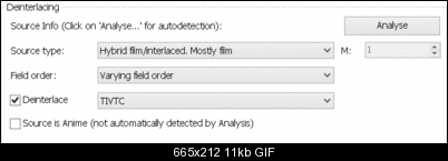

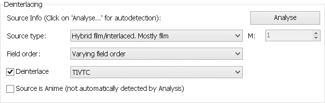

    I am still working with these older films of mine. This one though is in pretty good shape; I'm PRETTY sure that it simply is a rip straight from the DVD, except it's been (pillarboxed / windowboxed) in the sense that it is a WS film put into a 4x3 frame with added black borders top and bottom. So, I need to process it to get rid of the xtra black borders and bring it into a true 16x9 AR.
    When I was doing my due diligence and carefully stepping through it frame by frame, what I THOUGHT I was seeing was just the usual 3-2 pattern. 3 progressive frames and 2 interlaced ones (with the combing) BUT... when I used the usual code to IVTC it, in the preview player the processed image looked kind of jerky for some reason, which I thought was weird because I had not seen that before. So, I ran it through MeGUI to analyze it to see what it said, and it came back with the usual stuff:
    EXCEPT... this time it said something about 'varying field order'... WHAT...??! Usually on all these films, which are pretty much the same type of file, it comes back this way except it will say TFF. Here is the script it is recommending:
    LoadPlugin("D:\EXECUTABLES\MeGUI_2624_x86\tools\ls mash\LSMASHSource.dll")
    LWLibavVideoSource("C:\x\00000.mkv")
    LoadPlugin("D:\EXECUTABLES\MeGUI_2624_x86\tools\av isynth_plugin\TIVTC.dll")
    tfm(order=-1).tdecimate(hybrid=1)
    Usually, it seems that for WHATEVER mysterious reason, it almost always suggests some 'hybrid', either 1 or 3, which I guess as per your explanations before means some kind of blending, which I don't think I want or need. I don't know why it keeps doing that because just about all these films only need a simply IVTC and that's it, but it bloody INSISTS on adding the 'hybrid' factor, but I never use it.
    BUT... it DID look kind of jerky when I just applied the usual IVTC code which is 'tfm(order=1).tdecimate() without the 'hybrid' So, I thought I'd better post a snippet of it here to see if I am missing something. But, honestly all I could see in stepping through it, or in another part of the film, was the usual 3-2 pattern.
    http://lathe-of-heaven.com/TCT.mkv And YES! I chose only 10 seconds where there is continuous movement!
    Appreciate any input!

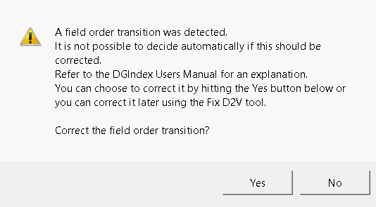

    Okay, in the process of trying this again, I am keeping all of the files in the same folder for one... Also, I took the first 5 minutes from the MKV file and then loaded that into DGIndex since I didn't want to re-encode the entire film every time to find out if it worked properly.
    Interestingly, in loading the 5 minute segment into DGIndex, I got this prompt:
    Interesting that this involves 'field order'...
    So, I'm just going to select 'No' for now and continue to run the encode to see what happens...
