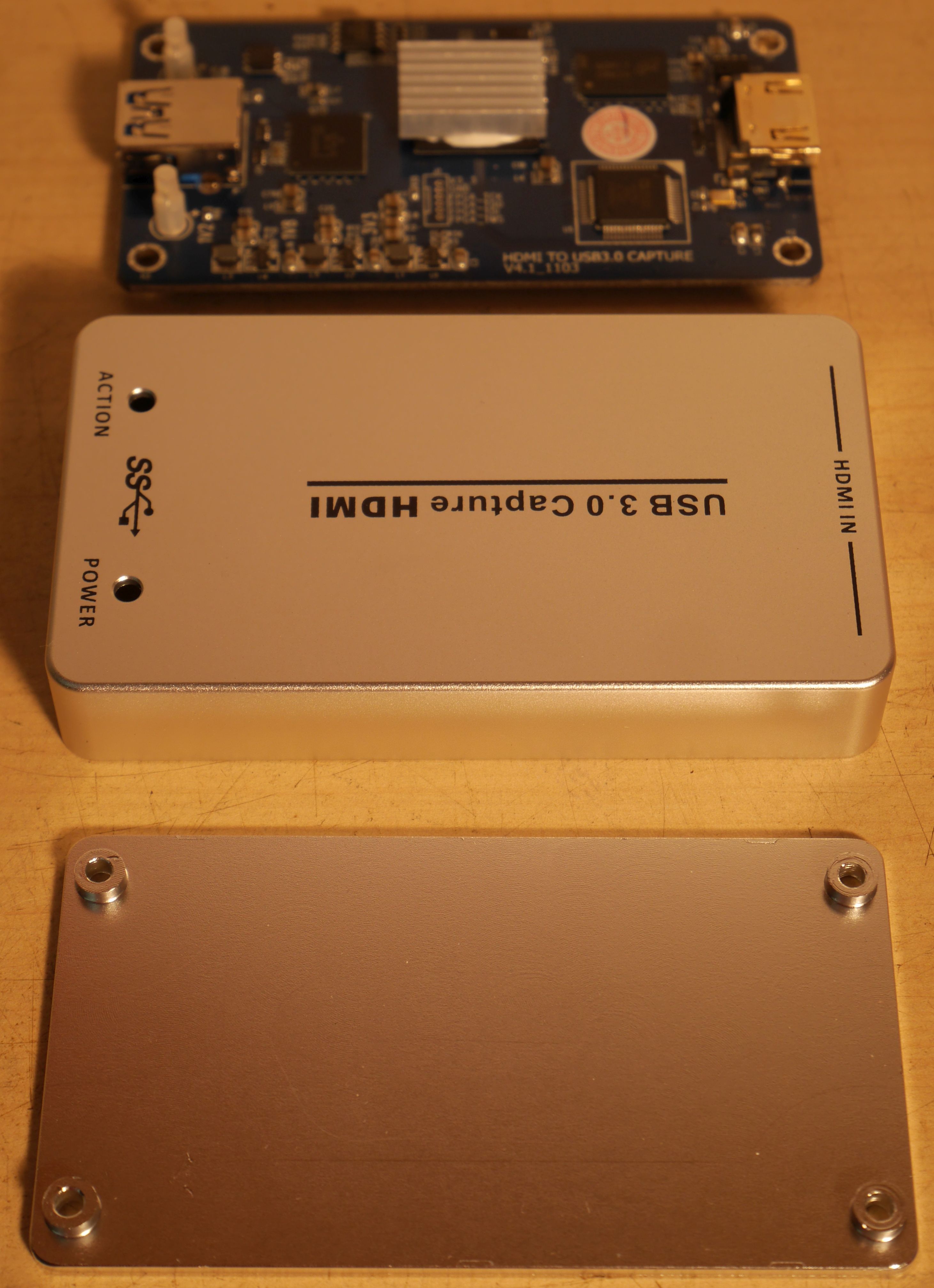

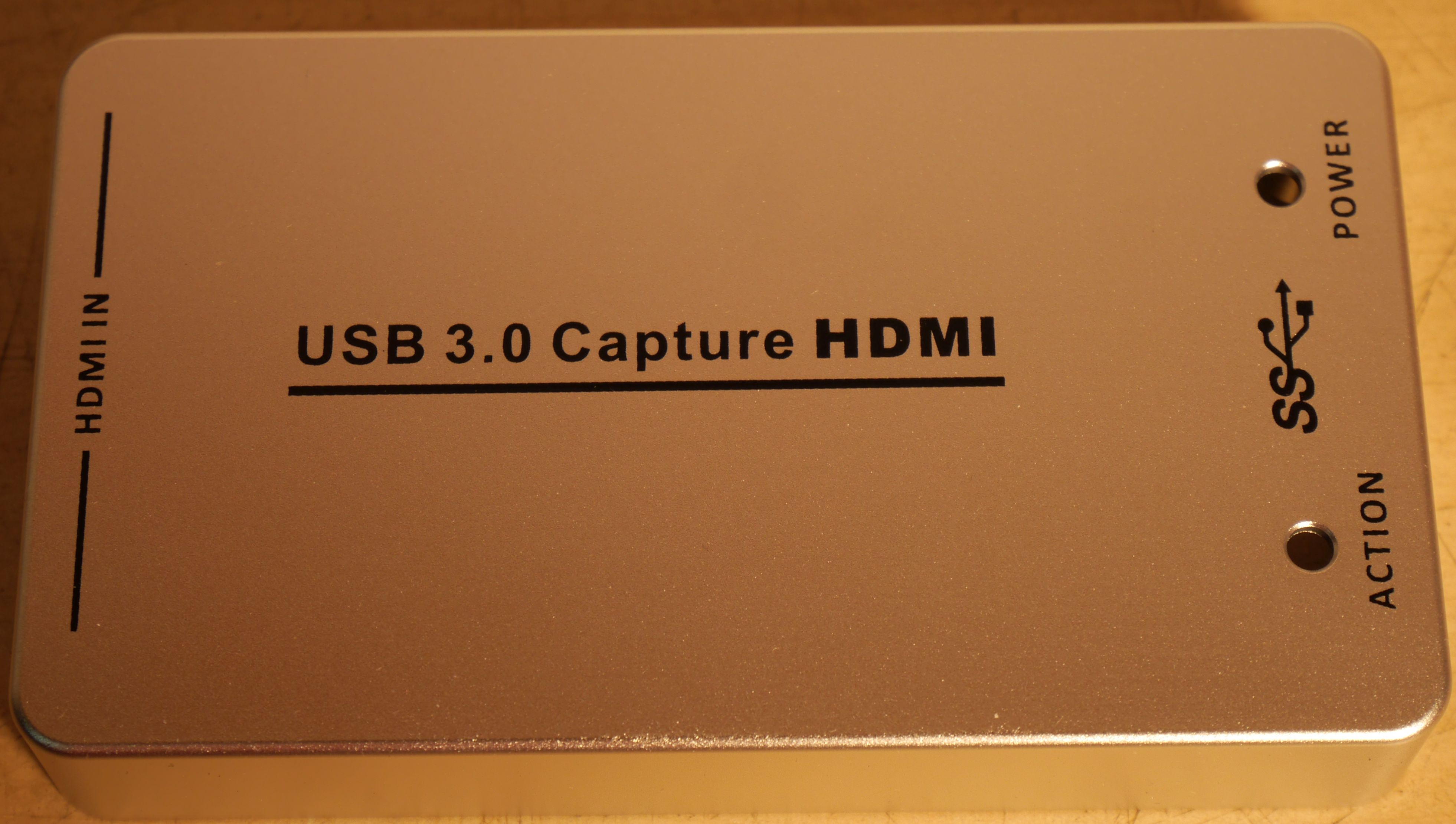

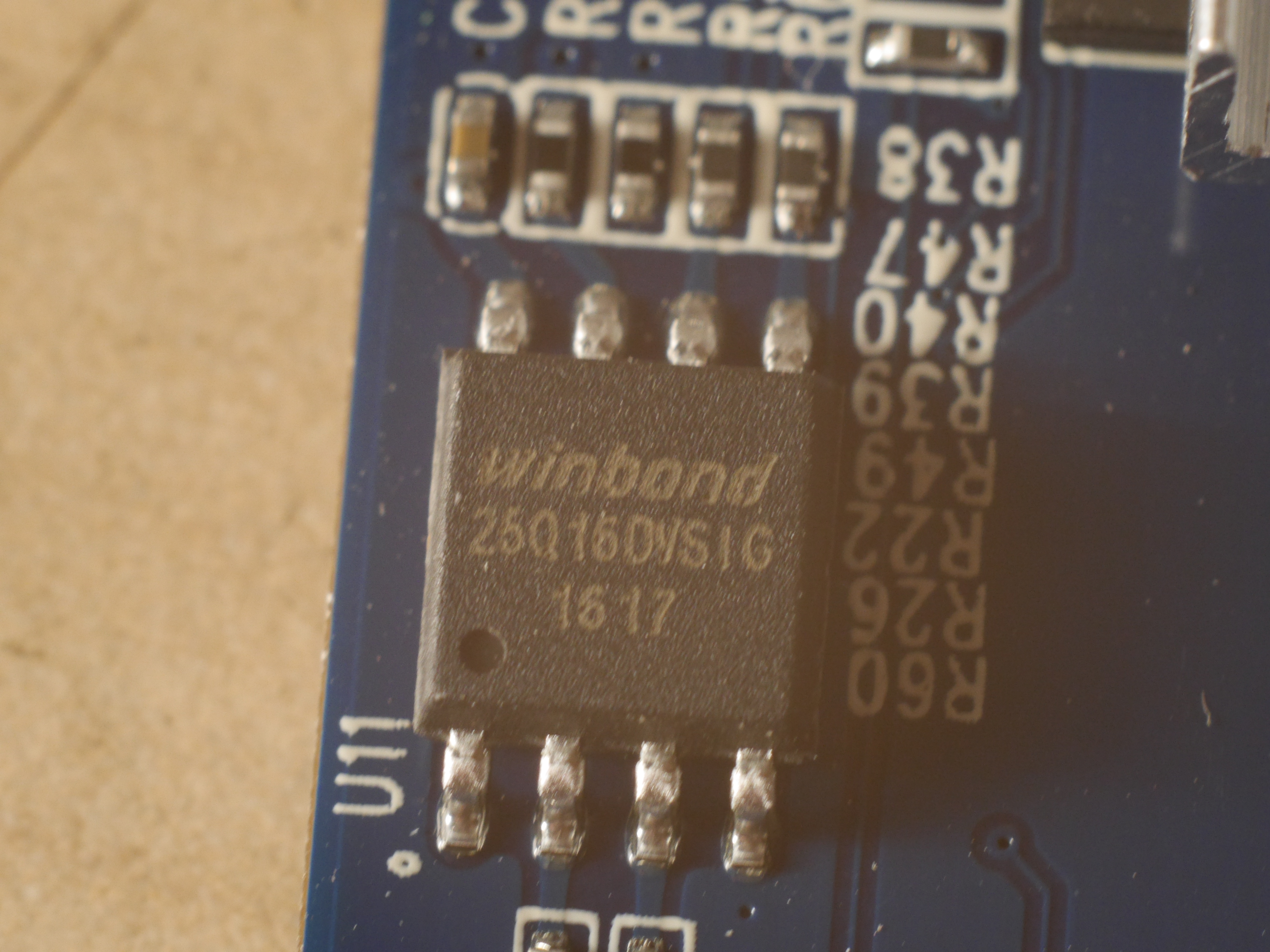

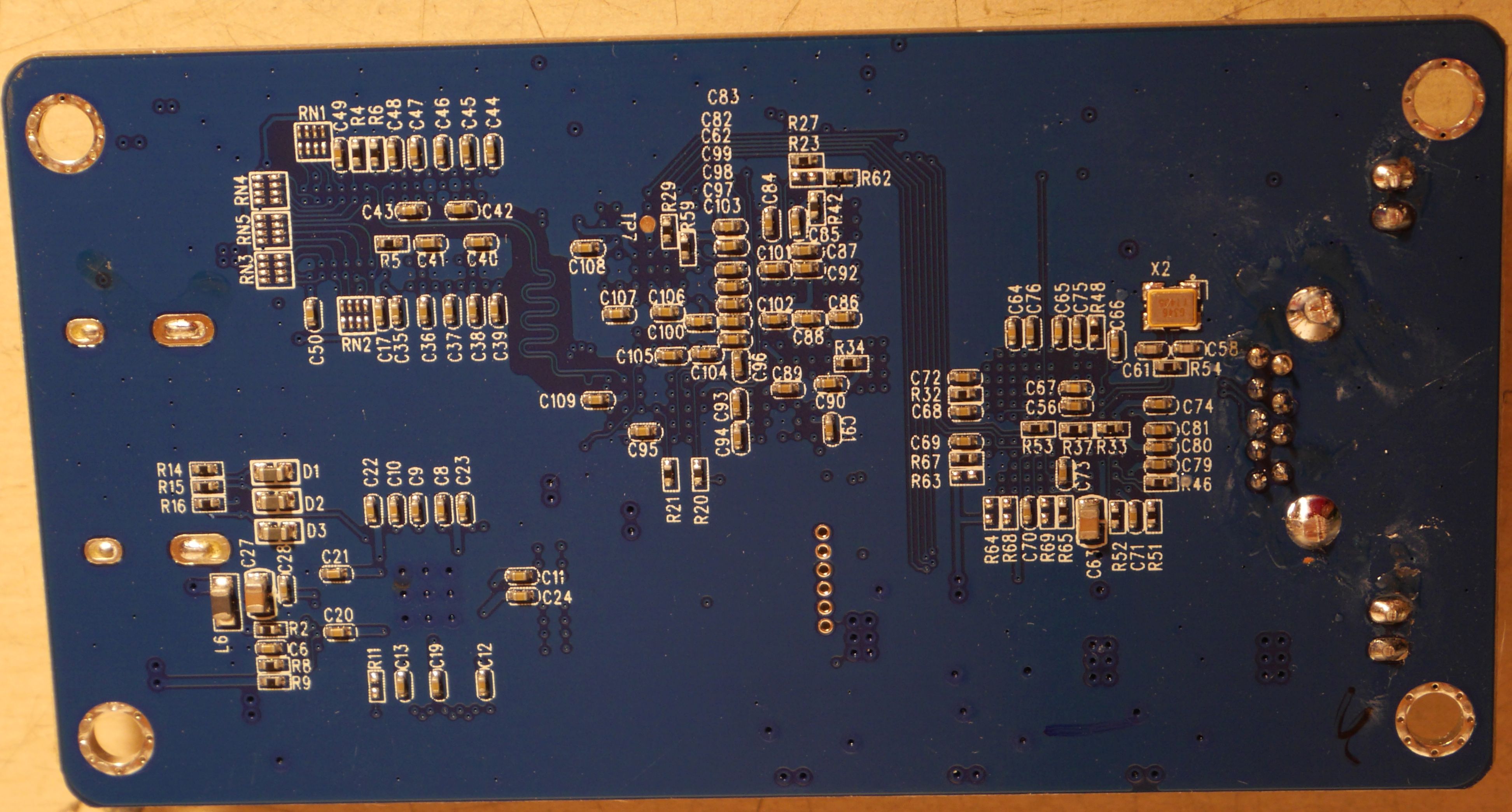

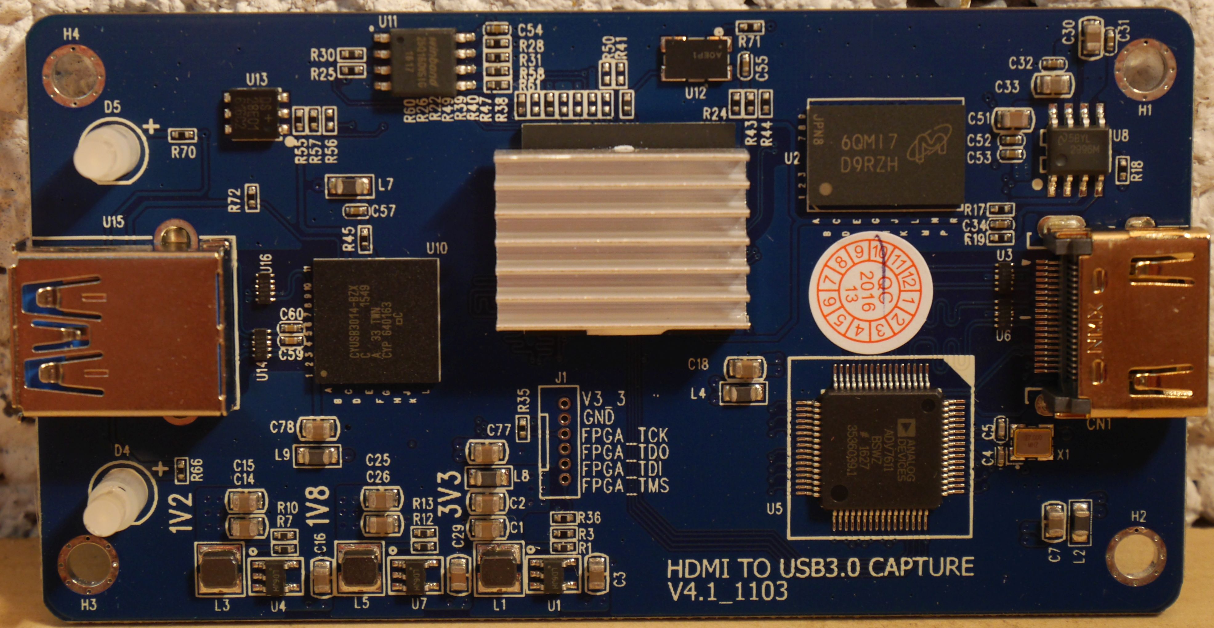

  1. I purchased one of these Chinese devices from Ebay:
    http://www.ebay.com/itm/XI100D-1080P-60FPS-UVC-USB-3-0-HDMI-Capture-Dongle-USB2-0-HDMI...QAAOSwYIxX~M5g
    On paper looks identical to the Magewell XI100DUSB, but is much cheaper.
    From testing so far, I am impressed with the device and was well worth the gamble. It does indeed capture HD at 60 fps.
    I have also taken the device apart and photographed the board and provided some close ups of some of the chips (see attached images). I did not remove the heat sink, as it seems to be bonded with some sort of ridged thermal paste.
    I would be interested to compare these pictures to a branded Magewell device. Has anyone stripped a branded Magewell down?

    The chip with the heatsink undoubtedly does the heavy lifting, so you will have to disassemble it for any meaningful comparison.
  3. Yes I know, but there is some weird solid thermal paste like stuff on the headsink binding it to the chip. I would have to cut it with a knife and did not want to risk damaging anything. It's not like the type of paste between a computer CPU and fan.
  4. The HDMI receiver looks like it is hdcp compliant. Have you tried any hdcp input sources with this device? thanks!
    edit: Here is a better pdf. It looks like the bswz is the hdcp 1.4 compliant one, and the bswz-p is non hdcp compliant. Yours appears to be the first one, but not sure:
    http://www.analog.com/media/en/technical-documentation/data-sheets/ADV7611.pdf

  6. Originally Posted by ezcapper View Post
    Thanks for your info, I think you may be right about that. I am currently away at the moment, but will test it ASAP.
    On another note, I am tempted to take the heatsink off and find out what the big chip is. Do you know what sort of thermal paste is likely to be on there and how to get it off? I will also need to buy some more to reapply - so need to know what it is. As I explained it's hard, not like the stuff on a computer CPU.
  7. Mod Neophyte redwudz's Avatar
    USA
    It's likely a thermal adhesive. I wouldn't try to remove it. With some types that are a bit soft to the touch you may be able to heat the heat sink with a thermal gun (Not a hair dryer) and twist the sink off with a pair of pliers. Some hard adhesive types can be cooled in a freezer and snapped off with a screwdriver before it warms. The hard epoxy types may be near impossible to remove without damage to the HS and chip.
    Acetone or maybe goo gone or fingernail polish remover may be used for removing the residue of some types of compound. Some of the soft types may be removed with 99% isopropyl alcohol.
    But I wouldn't risk either method on a working chip.
    Some types: http://www.aavid.com/product-group/interface/adhesive
  8. I wonder if this type of Thermal Adhesive would be suitable:
    http://www.ebay.co.uk/itm/Arctic-Silver-Thermal-Adhesive-Glue-Epoxy-7g-2x-3-5g-Tubes-A...0AAOSwQItTzPCJ
    I think if it is thermal Adhesive / Epoxy it would be very difficult to remove. Like redwudz said, I don't think I will risk it with a working chip. Also any chemical that removes Epoxy is also likely to make the identification on the chip unreadable.

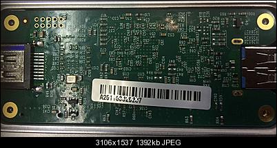

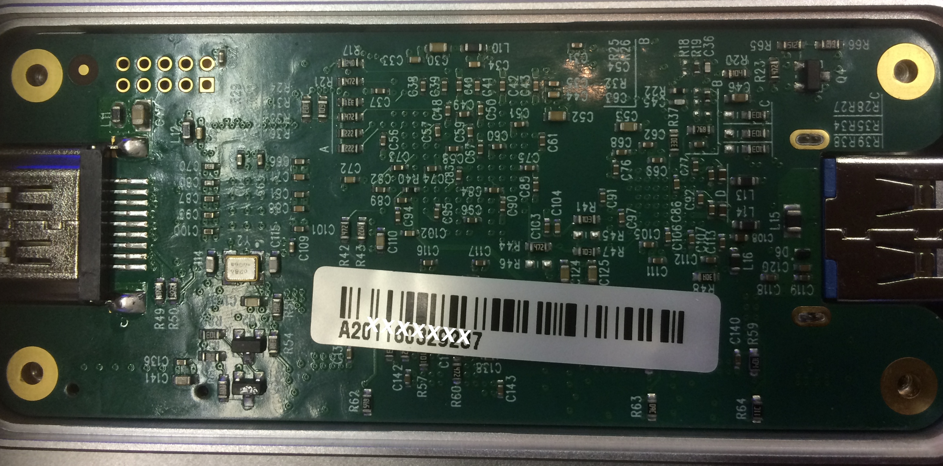

  11. I took the back off a genuine Magewell unit. The board is completely different.
    I was unable (did not dare to) to pull the board from the case as it was firmly stuck.
    Just looking at the back of the board indicates Magewell is much more populated and a completely different hardware design.
