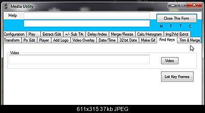

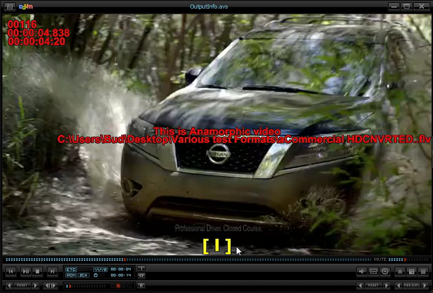

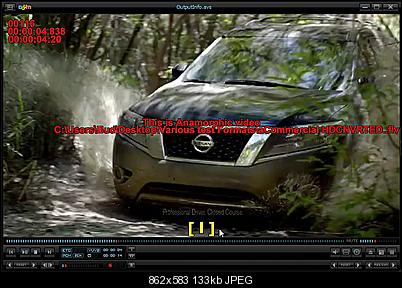

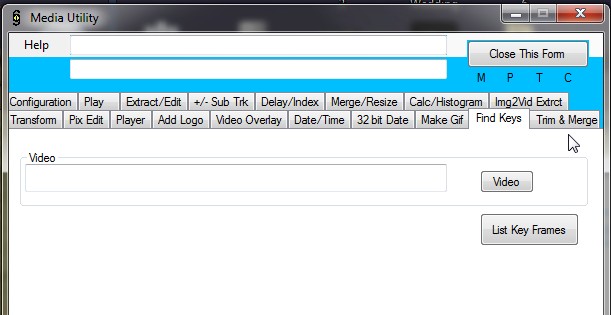

    It is possible with ffmpeg to encode just the part before the I frame but after the cut point but getting the specs to match the rest of the film so it can be put back together without glitches is the main problem. I have had great luck in doing it manually through all the steps but an automated version still eludes me.
Name:	I frame.jpg
Name:	ScreenHunter_200 Nov. 10 00.38.jpg
