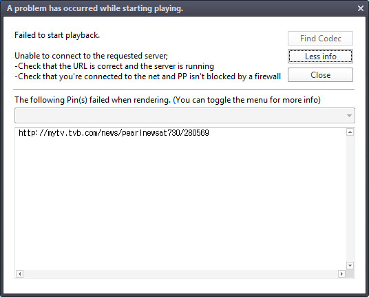

  6. From your screen capture, I notice that you're using "PotPlayer".
    I've installed the latest release of "PotPlayer" and allowed it on the firewall.
    But when I "Open URL" and enter the target "http://mytv.tvb.com/news/pearlnewsat730/280569", it quickly returns an error : Image
    [Attachment 39417 - Click to enlarge]
    It plays YouTube, but all other URL's fail, including its own bundled examples.
    Does it mean that I have missed something ?
    Also, I notice that "PotPlayer" does not attach to RTMPDumpHelper.
    In other words, even if PotPlayer plays my target URL, there's no way to save it.
