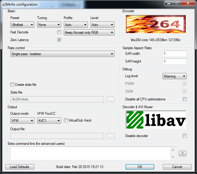

I love the x264 codec and I use it to record my games. I'd like to keep using it, but I read on several places people saying it's a "hack" even though it works for me. When I record the videos, I leave the settings like this:
I read that leaving it on "Single pass - lossless" and "Zero Latency" checked, fixes the "hack" problem. But I'd like to know you guys' opinion on it. Are those settings ok? or should I change something?

It is but so is Xvid in an AVI if it uses B-Frames. That's the problem.... the VFW system works on a one frame in, one frame out basis, and I don't think the AVI container has the ability to store information regarding the type of frames. When B-Frames are used the frame display order and the encoding/storage order might be different, so I think for AVC it's the same as Xvid. To get around the problem frames are packed together as a single frame or several frames have to be decoded before any can be displayed, causing a slight delay. The hacks are well supported though, especially for mpeg4 (Xvid, Divx etc). I don't know about AVC as I've not used it in an AVI for anything but an intermediate file for re-encoding on occasion.
The ultra fast preset doesn't use B-Frames so I assume the ultra fast preset on it's own would be enough to avoid any hackery. I'm not sure about the lossless mode. I don't think it uses B-Frames but I'm not certain.
Are you stuck with using the VFW version of x264 for a reason, or forced to use AVI rather than a more modern container such as MP4 or MKV? Playback support for h264 in an AVI is well supported on a PC but it's probably somewhat uncommon for standalone hardware players.Last edited by hello_hello; 8th Nov 2016 at 06:20. Reason: spelling
Like hello_hello said, it is kind of a hack but without b frames you are mostly safe.
Your options:
1. switch "Output mode" from "VFW" to "File". This will write to an extra file without AVI but VirtualDub will still create a dummy (or audio-only) AVI file. So you need to mux the video file and the audio-only avi back together later using e.g. mkvmerge.
2. switch to using the https://forum.videohelp.com/threads/367446-Virtualdub-External-Encoder-feature feature of VirtualDub. It supports encoding and muxing without AVI but is more difficult to set up initially. Since you are talking about capturing: I don't know if it possible to use it with VirtualDub capture mode.
3. continue using the hack. If it works for you .. why not?
x264 lossless does indeed not use b frames.Last edited by sneaker; 8th Nov 2016 at 02:51.

So... from what I gather, if I use x264's lossless mode I will be safe?
not necessarily ; it depends on how it's going to be used and what programs
By default, x264's lossless mode --qp 0 (or --crf 0) uses long gop with b-frames to increase compression . So that will lead to the same problems with decoding in susceptible programs ( green frames, black frames, out of order frames, out of sync...) . Some programs will have no problems
Also, many programs cannot decode AVC lossless mode properly
Using all I-frames (instead of long gop) will make out of order decoding less likely in AVI container . But that will significantly reduce compression efficiency .
Some people suggest disabling b-frames, but even p-frames can cause problems in some programs (e.g. vegas) with out of order decoding (mixed up frames). You can find many threads on this on various forums. -

Okay guys, so this is what I did:
1) Capture the game in VFW H264 - Superfast preset (beause Ultrafast fails on certain games) - Keep/Accept only RGB - Single pass lossless - Zero Latency checked.
2) Drag and Drop the .avi into VirtualDub - use the Resize Filter to increase the video's resolution by 8x - Select x264vfw as video compression method (select Convert to YUV 4:2:0 under x264vfw configuration instead of RGB so the video will play everywhere) - Save as AVI.
3) Drag and Drop the new .avi into Avidemux - Select "Copy" as Video Output - Select "AAC (Faac)" as Audio Output - Select "MP4 Muxer" as Output Format - Save the .mp4.
And that's all. Since the final video will be stored into .mp4 instead of .avi, will things be fine then?
P.S. Here is a video showing my whole process step by step: https://www.youtube.com/watch?v=6LI9HmzNBdA -
Yes, remuxing it into a suitable container will fix the problems associated with AVC in AVI, but not all programs or devices accept lossless AVC. So it still depends on how you 're going to be using it

Just to clarify: if a program/device/whatever doesn't support it, the video won't even play at all, right? or will it still play but bugged/glitched or something?
