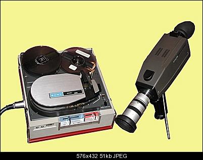

  15. Way WAY back when I was a teenager in the mid-1970s, my best pal's older sister got a job at a real estate company that was using the early Sony PortaPak 1/2" reel-to-reel systems. She would bring a VTR, battery and B/W camera home on weekends, and let us play around with the kit making silly videos similar to the Super-8 film projects we'd been doing for years.
    The fun wore off fairly quickly once we filled up our first 30 min reel and discovered additional blanks would cost a small fortune. My pal's father thought he could help us out by bringing home a couple of decommissioned reels of the 1/2" tape used in IBM mainframe computers at the phone company. We tried this in the PortaPak VTR, and the results were abysmal: the video image was obscured by a hailstorm of dropouts. I'm pretty sure we clogged the heads on the PortaPak, leading to an expensive service fee, but since it was their Dad's idea to experiment we weren't blamed. Needless to say, his sister never brought the PortaPak home again after that.
Name:	Sony PortaPak & Camera 1970s.jpg
