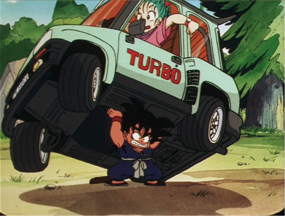

  1. Hello i try to do the best encode of my Dragon ball dvd in private way but there is a small problem i can't correct with avisynth
    a guy did it in his test but i can't contact him anymore.... i explain
    http://screenshotcomparison.com/comparison/184093/picture:1
    in the original one you have some red around line like a chroma bleeding or halo in the guy test it is solved (watch around goku's arm) .... i try some things but nothing work
    can someone help me?

  2. here a screen of the problem....it is very annoyig me and i need help for this problem i couldn't resolve myself with some search
    could someone really good to help me?
    ere a comparison between the original and what it should have to be
    http://screenshotcomparison.com/comparison/189673

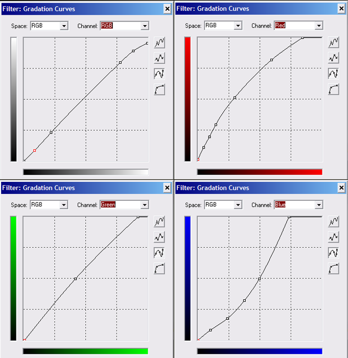

    The color balance is atrocious. Reduce dark blue, raise bright blue a little, add a small amount of green, add lots of red. I used gradation curves in VirtualDub and lowered saturation a little with ColorMill:
    gradation curve settings:
