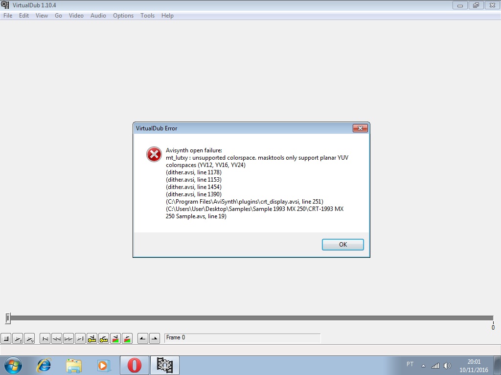

  1. Add ConvertToRGB() before crt_display().
  2. Member Caiosouza's Avatar
    Nov 2013
    Capćo da Canoa, RS, Brazil
    Import("C:\Program Files\AviSynth\plugins\crt_display.avsi")
    SetMTMode(3)
    MPEG2Source("C:\Users\User\Desktop\Samples\Sample 1993 MX 250\Sample 1993 MX 250.d2v", CPU2="ooooxx", Info=3)
    SetMTMode(2)
    LoadPlugin("C:\Program Files\AviSynth\plugins\mt_masktools-25.dll")
    SeparateFields()
    PointResize(width,height*2)
    Deblock_QED(last, quant1=35, quant2=40, aoff1=4, boff1=4, aoff2=4, boff2=4)
    PointResize(width, height/2)
    Weave()
    QTGMC(preset="fast")
    McTemporalDenoise(settings="medium")
    aWarpSharp(depth=5)
    Sharpen(0.3, 0.0)
    nnedi3_rpow2(2, cshift="Spline64Resize", fwidth=width*2, fheight=height)
    aWarpSharp(depth=5)
    AssumeTFF().SeparateFields().SelectEvery(4,0,3).We ave()
    ar = 1.0 / 1.0
    ConvertToRGB()crt_display (12*ar, 11, ppp=1.09*ar, sharpv=0.75, sharph=0.25, blurh=1.5, scandist=1, cutoff=0.8, gamma=2, glowgain=0.125, halgain=0.03, contrast=3, phosphor=true, maskpp=3, beamshape=1.0, vcs=0.25, cromaclear=1, voff=0, pgrid=true, halrange=3, mix=2)

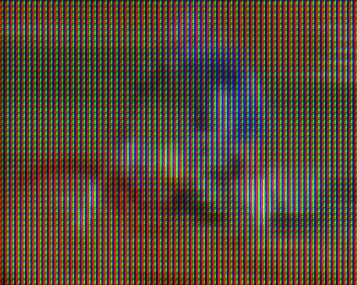

  3. You're trying to generate an image ~12 times width and ~11 times the height of the source, about 8448x6336. You're running out of memory.
    And I think crt_diplay() is meant for use on progressive frames, not interlaced frames. Giving it interlaced frames may lead to other problems.
    You really want to generate a DVD that looks like this?
    [Attachment 39411 - Click to enlarge]

  5. If you're going to do this there's no point in any of the other filtering:
    Mpeg2Source("D:\Downloads\1993 MX 250 Sample.d2v", CPU2="ooooxx", Info=3)
    Spline36Resize(60, 48)
    ar = 1.0 / 1.0
    ConvertToRGB()
    crt_display (12*ar, 12, ppp=1.09*ar, sharpv=0.75, sharph=0.25, blurh=1.5, scandist=1, cutoff=0.8, gamma=2, glowgain=0.125, halgain=0.03, contrast=3, phosphor=true, maskpp=3, beamshape=1.0, vcs=0.25, cromaclear=1, voff=0, pgrid=true, halrange=3, mix=2)

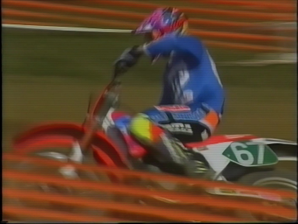

  7. crt_display() isn't multithread-safe. You'll need to run it single threaded. Try this:
    SetMtMode(5,1)
    Mpeg2Source("1993 MX 250 Sample.d2v", CPU2="ooooxx", Info=3)
    ar = 1.0 / 1.0
    ConvertToRGB(interlaced=true)
    crt_display (2*ar, 1, ppp=1.09*ar, sharpv=0.75, sharph=0.25, blurh=1.5, scandist=1, cutoff=0.8, gamma=2, glowgain=0.125, halgain=0.03, contrast=3, phosphor=true, maskpp=3, beamshape=1.0, vcs=0.25, cromaclear=1, voff=0, pgrid=true, halrange=3, mix=2)
    There's still some semblance of a CRT mask left at that size.
    [Attachment 39413 - Click to enlarge]

    And I get this.........damn colorspace
    SetMtMode(5,1)
    MPEG2Source("C:\Users\User\Desktop\Samples\Sample 1993 MX 250\1993 MX 250 Sample.d2v", CPU2="ooooxx", Info=3)
    SeparateFields()
    Weave()
    aWarpSharp(depth=5)
    Sharpen(0.3, 0.0)
    aWarpSharp(depth=5)
    ar = 1.0 / 1.0

  11. You probably have some library version conflict that's causing crt_display() to fail. If you just want some dark horizontal lines you can do something like:
    SetMTMode(5,4)

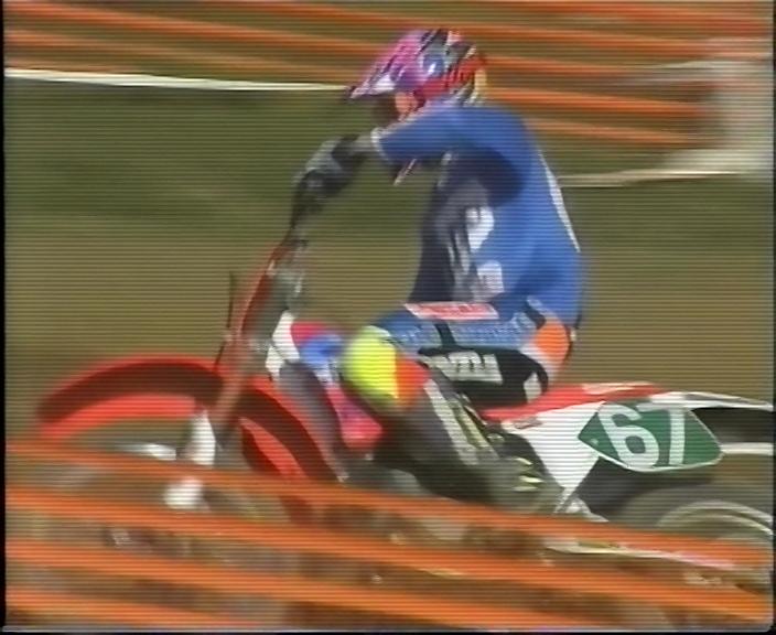

    Then encode that as interlaced MPEG 2 for DVD. It should something like this when you play it back:
    [Attachment 39416 - Click to enlarge]
    But I consider that butchering the video.

    What value do I control (set) a width of lines on the code? to approach maximum of the VLC effect ?
    WORKS FINE ON DVD COMPILED !!!!!
    PS: I knew it would be done, but only you could know how
  13. [QUOTE=Caiosouza;2466006]
    The downscale size, Spline36Resize(width,432). But there's a limit on what you can do without causing flickering and banding problems during playback.
    To get much thinner lines you'll have to upscale the video and leave a larger progressive frame. And then you won't be DVD compatible.

    aWarpSharp(depth=5)
    Sharpen(0.3, 0.0)
    aWarpSharp(depth=5)
    Sharpen(0.3, 0.0) #Wrong?
    Another segment of the same video:
