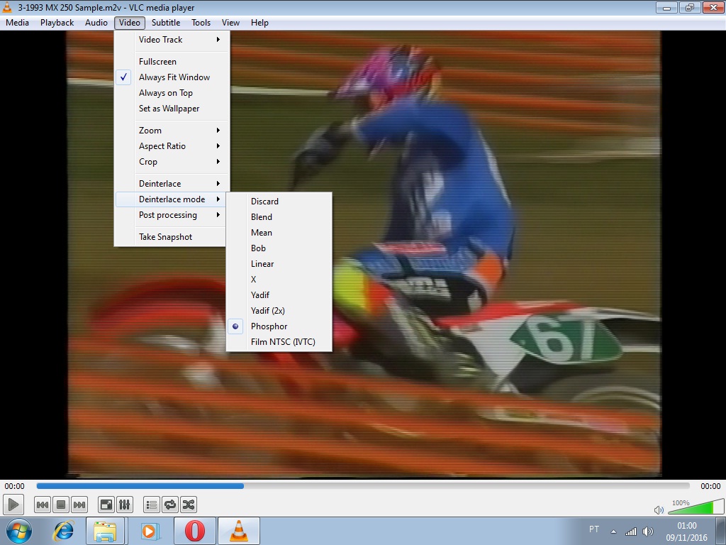

  8. Member Caiosouza's Avatar
    Nov 2013
    Capćo da Canoa, RS, Brazil
    See MCTD docs for the presets.
    Yes i did, on high remove more grain That's what i understood.
    I upload a Sample about the video I was mencioned, I notice some kind of grainy on it, which looks good on TV, is there a similar filter?
    Or a Similar Phosphor on VLC, this disguise many garbage, I love this
    Thank You
Name:	Filter Phosphor VLC.jpg
Name:	2-Filter Phosphor VLC.jpg

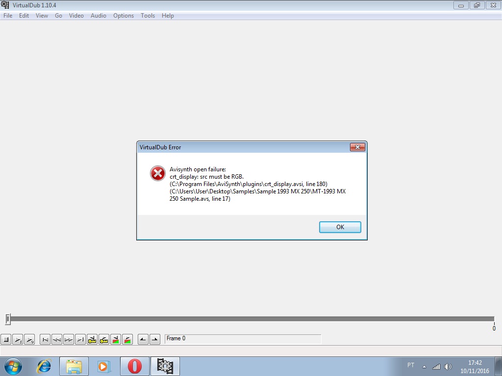

    crt_display v1.0
    Code I trying to load:
    Import("C:\Program Files\AviSynth\plugins\crt_display.avsi")
    SetMTMode(3)
    MPEG2Source("C:\Users\User\Desktop\Samples\Sample 1993 MX 250\Sample 1993 MX 250.d2v", CPU2="ooooxx", Info=3)
    SetMTMode(2)
    LoadPlugin("C:\Program Files\AviSynth\plugins\mt_masktools-25.dll")
    SeparateFields()
    PointResize(width,height*2)
    deblock_qed()
    PointResize(width, height/2)
    Weave()
    QTGMC(preset="fast")
    McTemporalDenoise(settings="high")
    aWarpSharp(depth=5)
    Sharpen(0.3, 0.0)
    nnedi3_rpow2(2, cshift="Spline64Resize", fwidth=width*2, fheight=height)
    aWarpSharp(depth=5)
    crt_display (5*ar, 5, ppp=2.5*ar, blurh=1.0, maskpp=2.5, phosphor=true, scandist=3, cutoff=0.8, glowgain=1.0, glowh=6, glowv=0, halgain=0.03, sharpv=2)
    AssumeTFF().SeparateFields().SelectEvery(4,0,3).We ave()
Name:	Error crt display.jpg
  16. I'm not sure why you would want something like VLC's phosphor filter but something like this comes close in AviSynth:
    # starting with interlaced frames
    SeparateFields()
    Interleave(last, last.loop(2,0,0).ColorYUV(gain_y=-96).Trim(1,0))
    Trim(1,0)
    Weave()

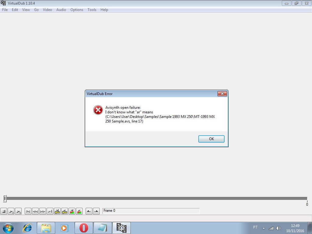

  17. In your crt_display() ar is the sample (pixel) aspect ratio. For a 704x576 4:3 PAL video that's 12/11, 1.09

  19. The phospor filter is a bob doubler. You can't write 50p video to DVD so it is being deinterlaced/decimated somehow when you encode for DVD.

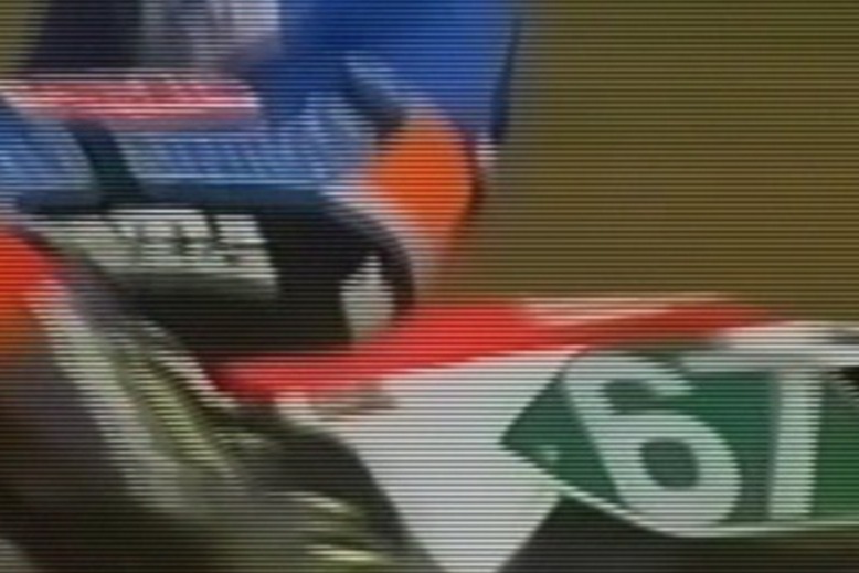

    So there is no way to let these lines as an effect on a DVD? Not even in video MPG, MKV, MP4,normal?
    Not like interlaced fields, but the effect filter, type "film grain" or any other superimposed (over,cover) effect to the video, like the VLC does?
    If The effect "crt_display v1.0" may no stay on the video, why doing this filter then?
    What utility have that then?

    Why do you want those lines? Do you just want a darker picture?
    The lines disguise the "Washed out" look on processed (and poor) video, i like the look when i put this on VLC, but I wanted this to work anywhere, without having to use the VLC filter

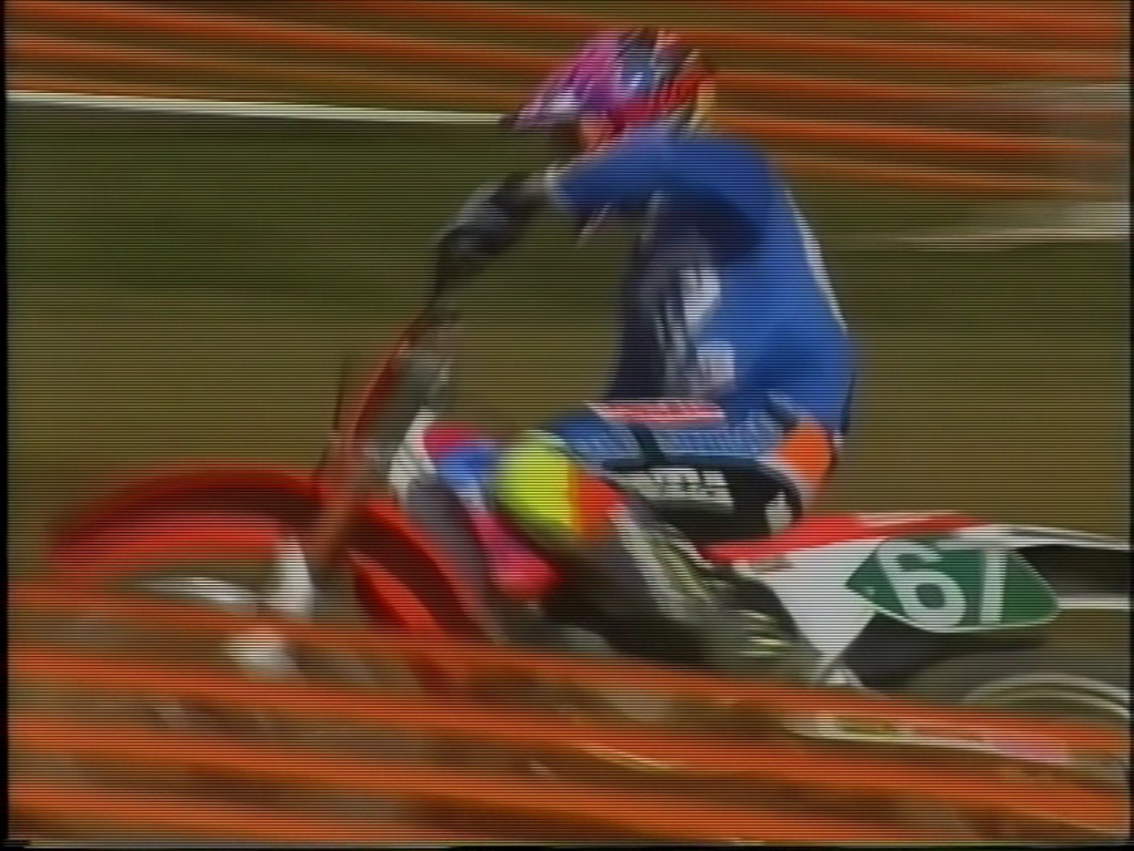

  25. What you mean by washed out look? Do you want a darker blacks with more color saturation?
    [Attachment 39408 - Click to enlarge]
    No, I mean: worn image by processing, someone like this: example "figured":
    Very Processed:
    As if you were watching a poor youtube Video 240p full screen
    "Outworn" "Low Detail" "Washed"
    You could help me to do this crt_display v1.0 work, I do not...
  27. As I noted before the problem is that your source has no detail. About all you can do is smooth away all the blocky artifacts -- but you'll still have no detail. There's no way to get back the details of the original broadcast. Adding black lines between each scan line doesn't increase the detail. And you can't do it properly on DVD anyway. You can do it in an MP4 or MKV file but you will have to encode it as 50p.

    The question is:Wonder if you help me to make it work in avisynth: crt_display v1.0
    Requirements: Dither 1.26.0 (I Have) or above and its dependencies, Avisynth 2.6, RGB colorspace. (I do no)
    What is wrong in this?
    ar = 1.0 / 1.0
    crt_display (12*ar, 11, ppp=1.09*ar, sharpv=0.75, sharph=0.25, blurh=1.5, scandist=1, cutoff=0.8, gamma=2, glowgain=0.125, halgain=0.03, contrast=3, phosphor=true, maskpp=3, beamshape=1.0, vcs=0.25, cromaclear=1, voff=0, pgrid=true, halrange=3, mix=2)
    RGB colorspace???
Name:	Error crt display 2.jpg
