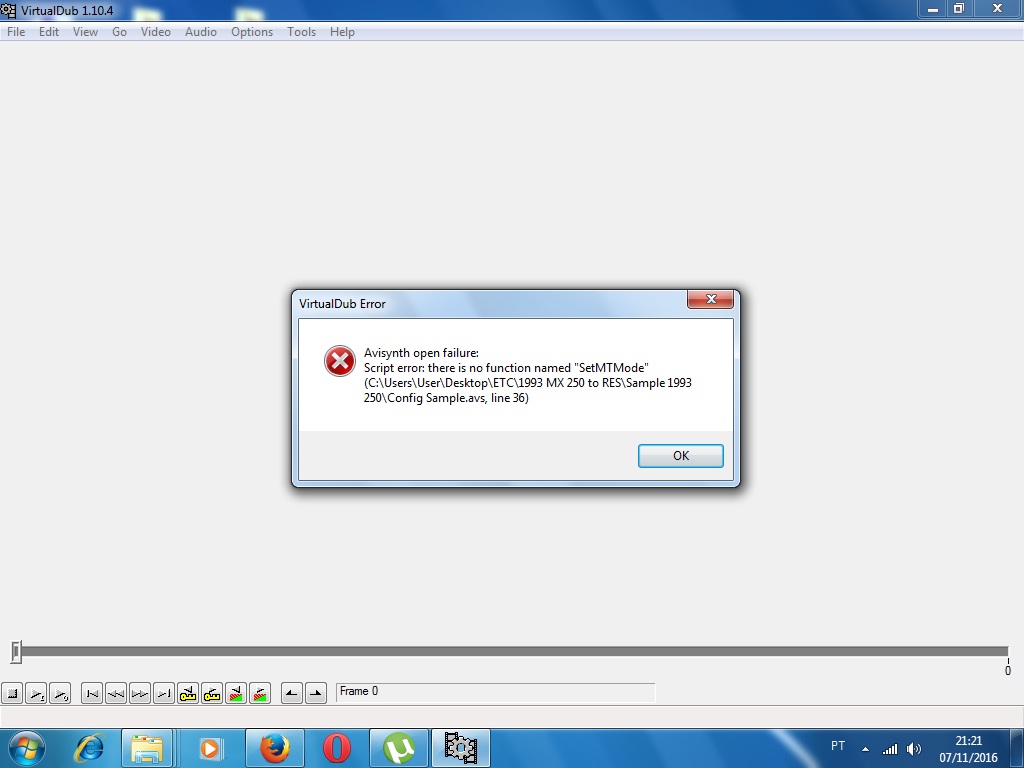

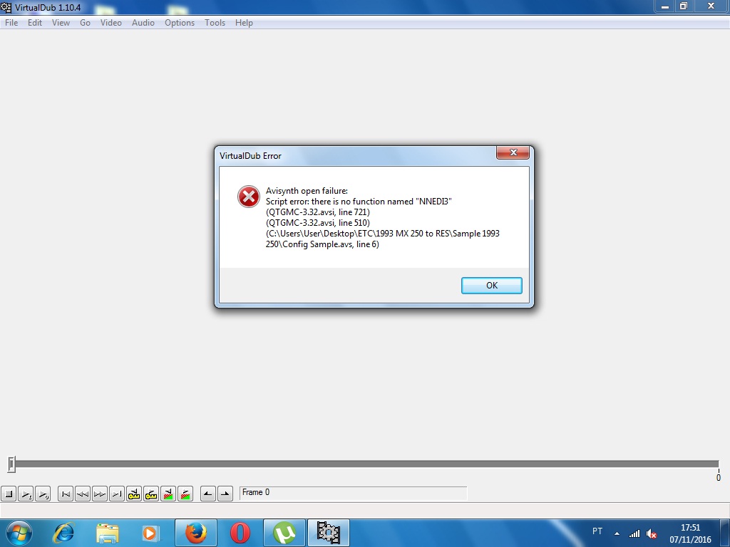

    I downloaded required plugins and getting lots of error in Santiag (no named function) and Nnedi3, i tried avisynth 2.6, but a return to 2.58 because this run fine for me, any similar filter code to replace Santiag and TemporalDegrain to 2.58?
    Thank a ton!
  14. Both of those filters work in AviSynth 2.58 and 2.6. Both are AVS scripts. Did you import them into your script?
    import("C:\Program Files (x86)\AviSynth\plugins\TemporalDegrain.avs")

    Yes i think too, in 2.58 the error is " no function named NNEDI3" ...in 2.6 I recieve: " no function named TemporalDegrain and Santiag"
    Many hours...and very difficult to find a solution...

  18. That's the same Santiag I have here. If you look at the link I gave it lists nnedi3 as one of it's requirements:
    http://avisynth.nl/index.php/Santiag#Required_Plugins
    So you have to download the nnedi3 package and put nnedi3.dll in AviSynth's plugins folder (where it will autoload) or put it somewhere else on your computer and import it manually within your script:
    LoadPlugin("C:\Path\To\nnedi3.dll")
    TemporalDegrain is the same one I'm using too. Again, the link I gave indicates what other plugins you need:
    http://avisynth.nl/index.php/Temporal_Degrain#Required_Plugins
    Download the ones you don't already have and put them in AviSynth's plugins folder or import them manually in your script.
  19. Member Caiosouza's Avatar
    I do it, but not...damn nnedi3...
  23. It's for use with a multi-threaded version of AviSynth. If you're not using one then remove or comment out (put a '#' in front of the line). That script looks slow even with a multi-threaded version of AviASynth. Without one it'll be even slower. Good things often take time. It also looks to me to be difficult to get going (to open because of the difficulty you might have with some of the required functions).
  24. Member Caiosouza's Avatar
    Nov 2013
    Capćo da Canoa, RS, Brazil
    Thank You!!! Worked! I will test this code now!
