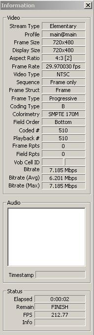

  7. Originally Posted by TeNSoR View Post
    Thanks, Sir! for your reply but I checked it by DGIndex and showed "Film",
    Are we speaking of the same sample? Your demuxed.m2v is all progressive and reads as NTSC, not Film. Every sixth frame is a duplicate and many of the frames are blended. It's a mess, even by the low Indian standards. Or have you already 'deinterlaced' it? Rather than worrying about the noise, your first job should be to remove the dupe frames and the blends, and secondly to try and correct the greenish tint over everything. And it's kind of 'dark'.

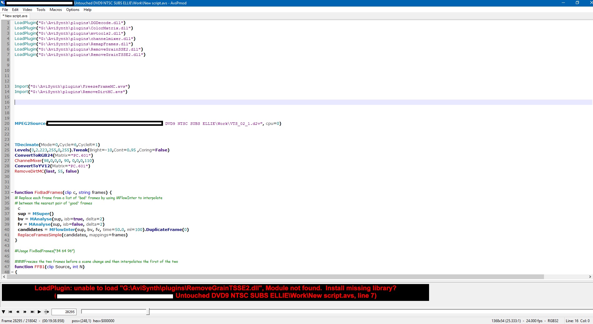

    Sorry again, manono, I still getting error message because of "RemoveGrainTSSE2". I copied the script you've uploaded into AvsPmod
    but I getting this error, any idea?

  24. Do you even need RemoveGrainTSSE2.dll? I don't have it and RemoveDirtMC runs fine.
    One problem with RemoveDirt and RemoveGrain is that there are so many different versions. Getting the right combination can be difficult.

    I removed RemoveGrainTSSE2 from Avisynth plugins and still the error :
    Thank you for your help LMotlow, just one thing if I want to encode the DVD into x264, is there's a way through Virtualdub?
    Sure, but I thank manono for teaching me a couple of new routines in this thread. I don't use VirtualDub for encoding, but I know it's done. I think an answer will show up here soon from those who've tried it.
    If you still have a removegrain problem, try installing the newer rgTools. http://avisynth.nl/index.php/RgTools
    I don't use Virtualdub too just x264 CLI and no problem with RemoveGrain now, Thanks anyway for you and manono
