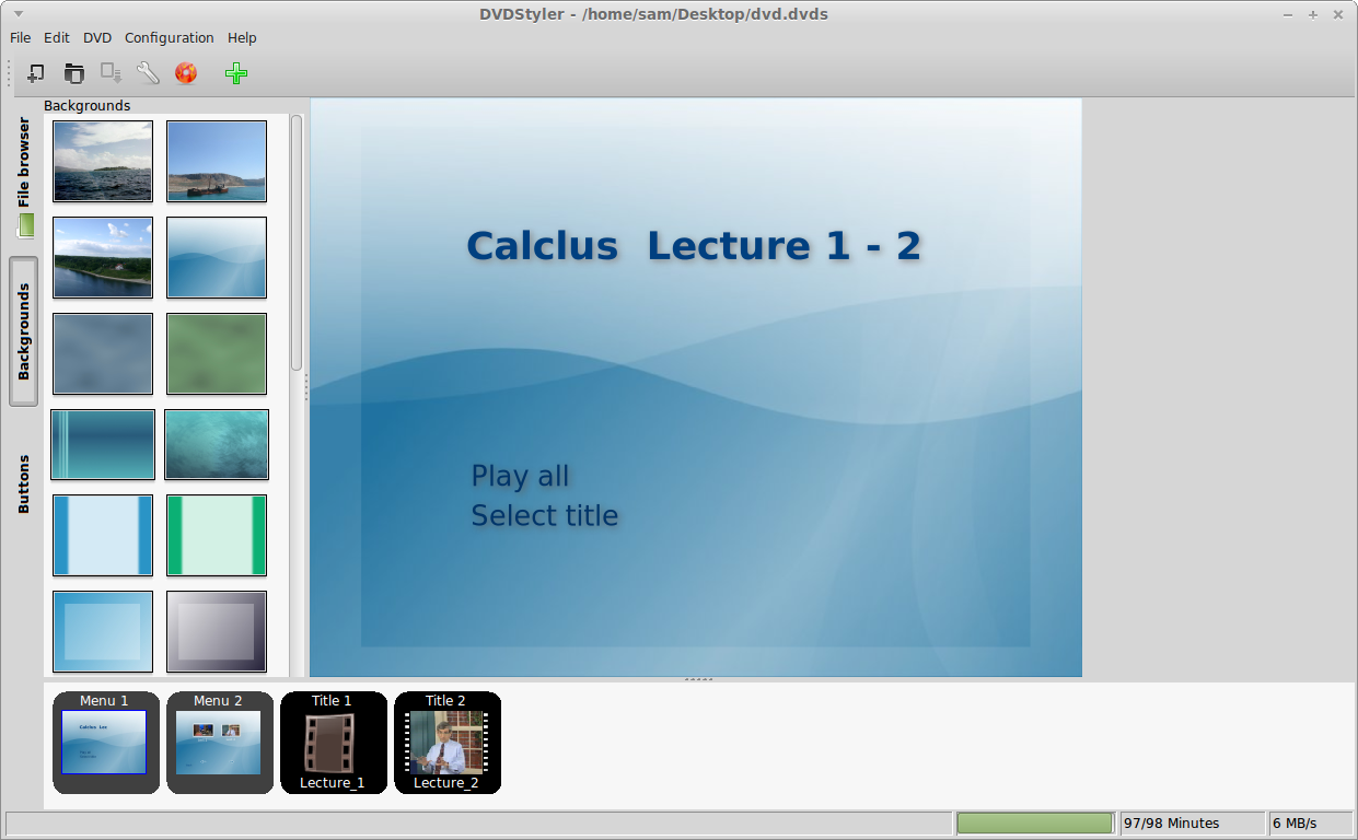

    I am trying to move some videos from VHS tapes to DVD so I can throw away the tapes. I have captured the videos and edited them down as much as possible. I also split them
    into pieces so I can have menus on the DVD I'm trying to make and skip to the piece I want to watch or just "play all". I'm doing this on Linux Mint 17.3 (?) but can also use Windows 7 if need be. I finally got projects ready to burn with Bombono and DVD Styler.
    Bombono gets avconv failure: exit code = 1 when I go to burn the DVD
    Dvd Styler Crashes when I try to burn the project ( the window disappears then nothing else appears to be happening )
    I got them both from the repository so you'd think they install any other packages needed. The video is a bit shaky when I play the captured mpg files on any of my computers
    so I am also hoping there is some way to stabilize that in the final product. I would like to get Bombono and Styler to work first though. I'm sure I will have more questions later
    since I'm New to video editing/authoring.

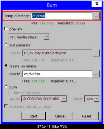

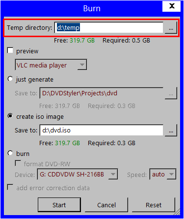

    It should be in your "Temp directory" (if created at all)

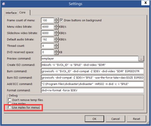

  7. It appears DVDStyler stop when creating menus.
    You could try "Settings -> Core -> Untick Use mplex for menus".
    Oct 2016
    Minnesota
    same behaviour as before
    took some screenshots but don't know how to paste them in here, will try to upload them as .png file
Name:	Screenshot-DVDStyler - -home-sam-Desktop-dvd.dvds.png
