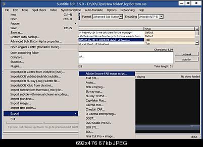

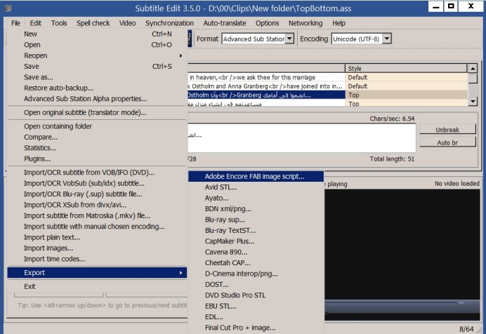

  15. Never used it but Subtitle Edit can export FAB from .ass
  16. videobruger, yes it can, I've tried it. But the result is very ugly, pixelated and does not support top and bottom at the same time.
