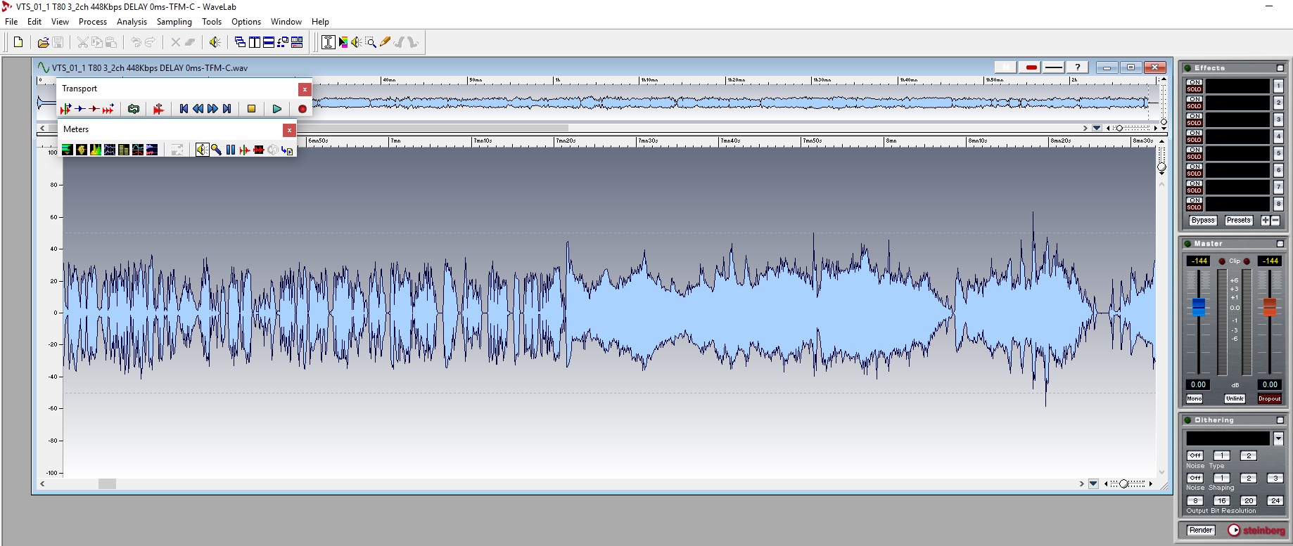

    I could find the demo version from the program, Skiller. Will you show me how to measure RMS of the entire file?

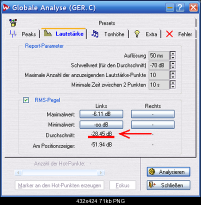

  6. Member Skiller's Avatar
    Oct 2013
    Germany
    Press ctrl + A to mark the entire waveform.
    Then just press Y to bring up the Global Analyze tools.
    Then select the Volume tab.
    Increase the threshold to -70 or more (well, less actually, since it's negative).
    Click "Analyze" and the average RMS volume will be displayed after it's done scanning where it says Average.
    In my example (sorry it's the German version of WaveLab) it's -28.45 dB, hence I would set the Dialog Normalization setting for AC3 encoding to -28 dB.

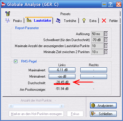

    Thanks again for reply I ran the analysis like you showed me and got this :

  10. Member Skiller's Avatar
    Oct 2013
    Germany
    Try if increasing the threshold to -100 changes the average volume by a few dB.
    -18 dB is almost certainly not correct, especially since you already mentioned the AC3 becomes very quiet.
    You should also look for a dialog scene of a few seconds (less than 10 seconds) with no loud background noises and measure that part the same way. Just mark it with the mouse and then analyze. Typically, Dial Norm should be in the range of -24 to -29 dB.
    I did so and gave me the same value (-18db) and you're right the Dvd source is odd (Old Hindi) even I tried AAC in MeGUI and the same problem, Thanks so much Skiller for your help
