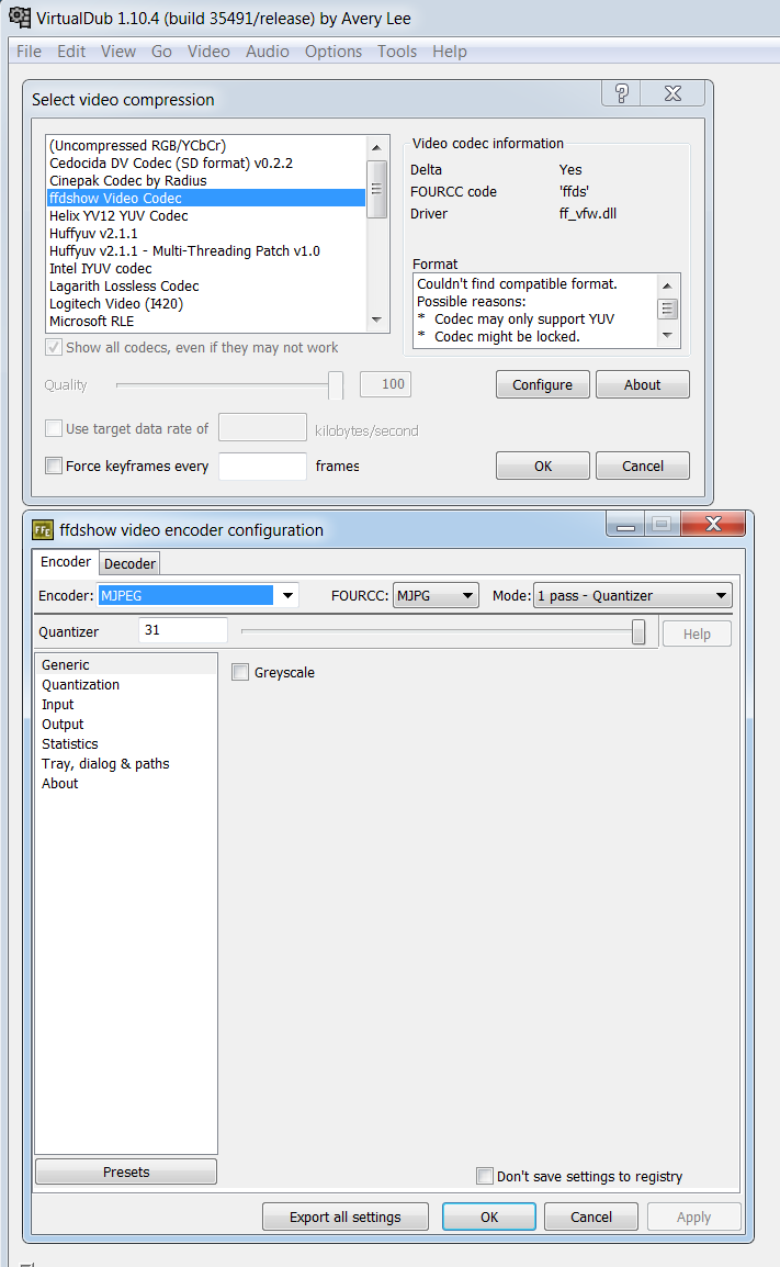

    I don't understand what you're asking. ffdshow includes a VFW encoder that you can use in VirtualDub.
    [Attachment 39166 - Click to enlarge]
    The only way to use a DirectShow encoder that I know of is to frameserve from VirtualDub to another program.

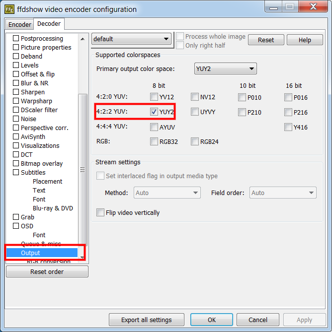

    [Attachment 39173 - Click to enlarge]
  16. but this is the output of the ffdshow decoder. I need only encode using ffdshow, and this should be 4:2:2. The NLE open .mjpeg files using his internal decompressor so the FFDSHOW decompressor settings does not affect nothing in my case. I wonder if is the there a way to encoding mjpeg files in 4:2:2 using ffdshow but seems to me this is not possible with ffdshow. I have set the decoder to YUY2 output... but mediainfo show that the file output is alwais 4:2:0. In every case my NLE don't read this mjpeg .avi files.

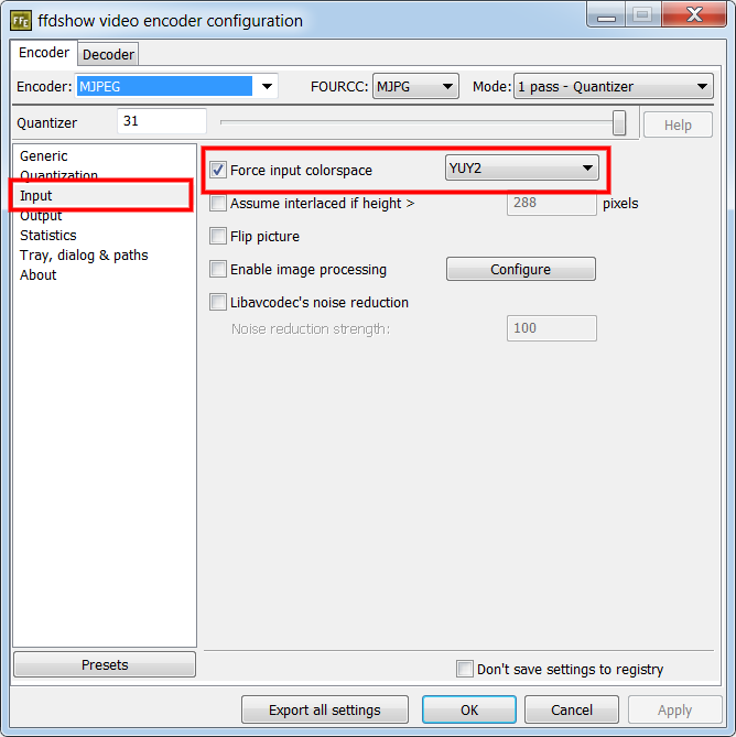

  17. I can't believe you can't figure this out for yourself. Feed ffdshow YUY2 and force it to encode YUY2.
    [Attachment 39174 - Click to enlarge]
  18. I already have try this, but it persist don't encode in 4:2:2. Mediainfo says that the encode .avi mjpeg file is 4:2:0

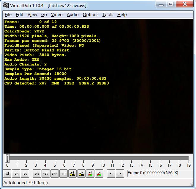

  19. Like I said before, it doesn't matter what MediaInfo says. If you force ffdshow to encode 4:2:2 and force it to output only 4:2:2 that is what you will get. Open one of your 4:2:2 files with AviSource() and view Info(). You'll see it's 4:2:2.
    [Attachment 39175 - Click to enlarge]
    Internally, ffdshow may continue to use 4:2:0 chroma but it will output only 4:2:2. It's much more likely your NLE simply doesn't like the fourcc.
