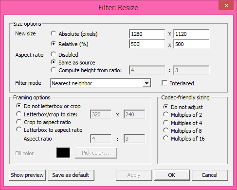

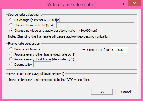

What I do through VirtualDub is resize the video by 5x (with nearest neighbour/point resize) and then convert the video's fps to 60. I leave my configurations like this:
My question is, how can I do EXACTLY what I do on virtualdub (resize and fps conversion) through x264's commandline window alone? Can someone inform me the commands I should type down to get vdub equivalent results?
