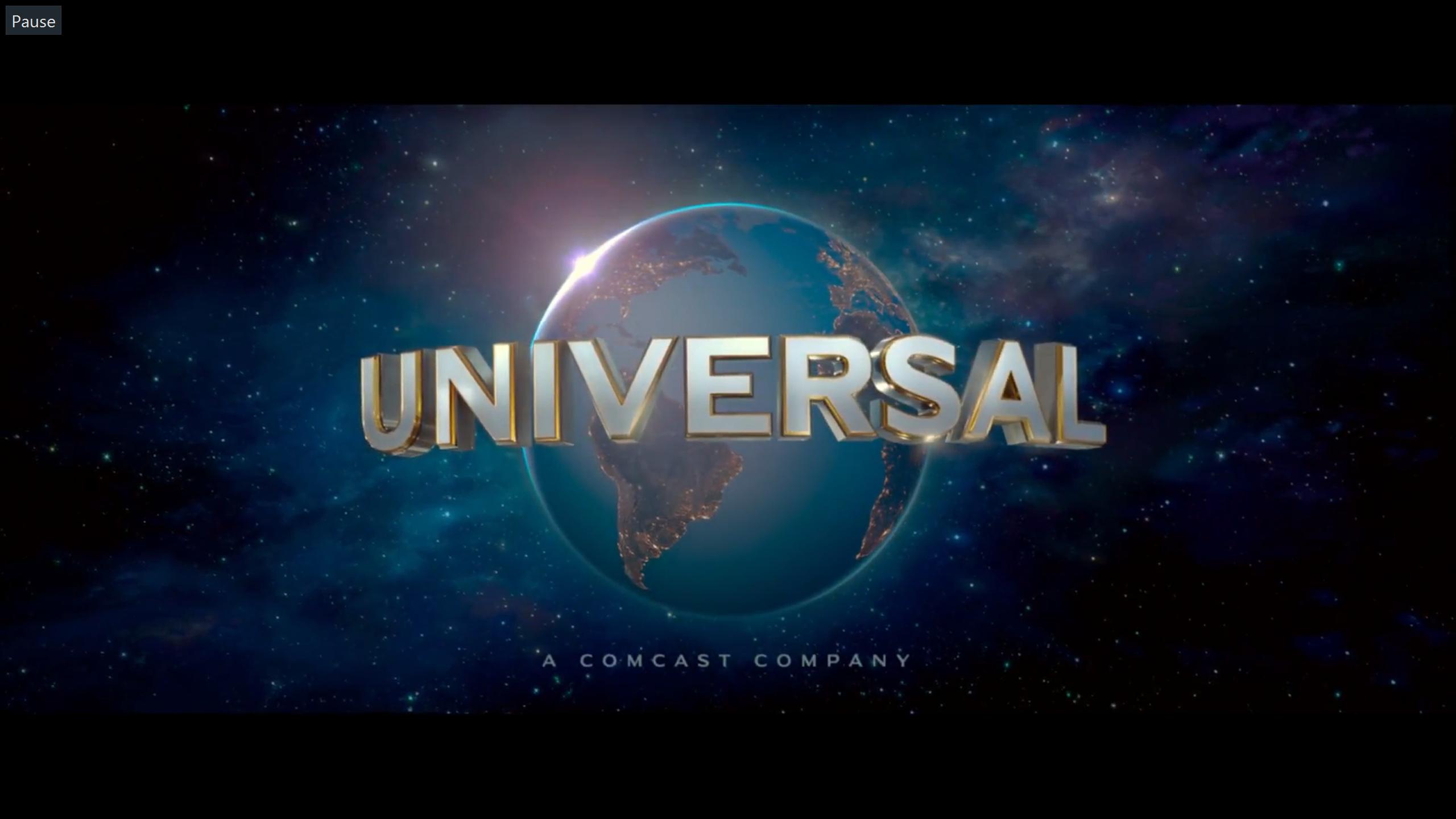

    Here are two video clips. The first one is the original format uploaded into google photos. The second is a reformatted clip I made using 1920x1080.
    YOU HAVE TO CLICK THE VIDEO FOR IT TO START
    ORIGINAL 1920X808 VERSION
    https://goo.gl/photos/PMr59wiWBASsHQ2r7
    REFORMATED 1920X1080 VERSION
    https://goo.gl/photos/rUnJ3wcx8sYqpnqP8

  7. If you're really a MoveeBuff you should know that virtually no movies are shot at 16:9.
    The original video has the correct aspect ratio, ~2.37:1, and should be displayed correctly when played. Your reformatted version is an abomination. If the earth looks round when you play the second video on your TV there's something wrong with the setup on your TV.
    Oct 2016
    The original version of the Universal logo earth looks like an oval on my screen. The reformatted one looks round. I'm aware that movies aren't shot in 16:9, however the movie files should have the proper aspect ratio when you play them in a media player or stream them without having to tweak the aspect ratio. I'm not saying you are wrong, just that for some reason, I'm not seeing things the same way you are. I don't know what the problem could be. The reformatted version still has black bars on the top and bottom and I wouldn't expect a reformatted version to fill the entire screen without losing the sides of the picture.
    What do you all think? Which version looks better?
  9. Originally Posted by Moveebuff View Post
    Then either your TV or your media player is set up incorrectly. The original video should show with the correct aspect ratio with letterbox bars top and bottom.

    I'm playing the files on my computer and connecting it to my TV with an HDMI cable. Maybe the computer is doing something with the aspect ratios.
    The original version shows letterbox top and bottom but if you were able to put the letterbox spaces on top of one another, it would take up half the screen with black space.

    Well on my PC monitor which is a 1920 x 1080 screen the first oriiginal of your examples looks perfectly fine. A round Earth and clearly a 2.37: 1 film. The second image you posted "reformatted" looks dreadful, the Earth is strongly elliptical in the vertical plane.
    Go with the originally - it seems like you have a problem with both your PC and TV ?

    Again, either your player (computer) or TV is set up incorrectly. The first video is correctly encoded and correctly flagged as far as the aspect ratio is concerned (at least very close, the movie is actually 2.35:1, according to IMDB). It will display correctly on a properly set up system. Here's how it displays on my 2560x1440 monitor:
    [Attachment 39164 - Click to enlarge]
    And it looks like that on five or six other computers and TVs in the house.

    I'm not sure what the resolution on my computer is, however when I plug the HDMI line from the computer into the TV, the aspect ratio of the computer changes and looks like it's displaying a 4:3 picture on the computer with black bars on the left and right on the computer monitor. When I unplug the HDMI, the computer monitor returns to fullscreen mode. I have a feeling that the computer is altering the aspect ratio when I plug it into the TV. If i'm watching cable TV, the TV is always fullscreen unless they are broadcasting a movie that is letterboxed. In that case, the picture is fine. I'm only experiencing issues when the computer is plugged into the TV. I have no clue how I would adjust the aspect ratio settings on the computer for this type of configuration.

    original as a screen capture using snipping tool

    I just tried an experiment. I unplugged the HDMI from the TV and watched the two clips on just my computer. The original version was much better on the computer. The earth was perfectly round. The second edited clip the earth looked totally elongated. The TV is set to 16:9 mode. The TV is stretching out the computer image to display the full computer desktop on the TV screen. I don't know know what to do now to get the TV to display the same way it did on the computer.
  16. Don't run the secondary display (TV) in mirror mode. Set it up as a separate display. Set the resolution to the TV's native resolution.
    Oct 2016
    I realized that my TV was set to display 16:9 aspect ratio so I changed it to stretch to picture mode. The good news is, using MPC, I selected "touch video from inside", and "Keep aspect ratio". Now the picture looks perfect in the original 1920x808 resolution. Thanks for everyone's help and suggestions Problem solved. Case closed
