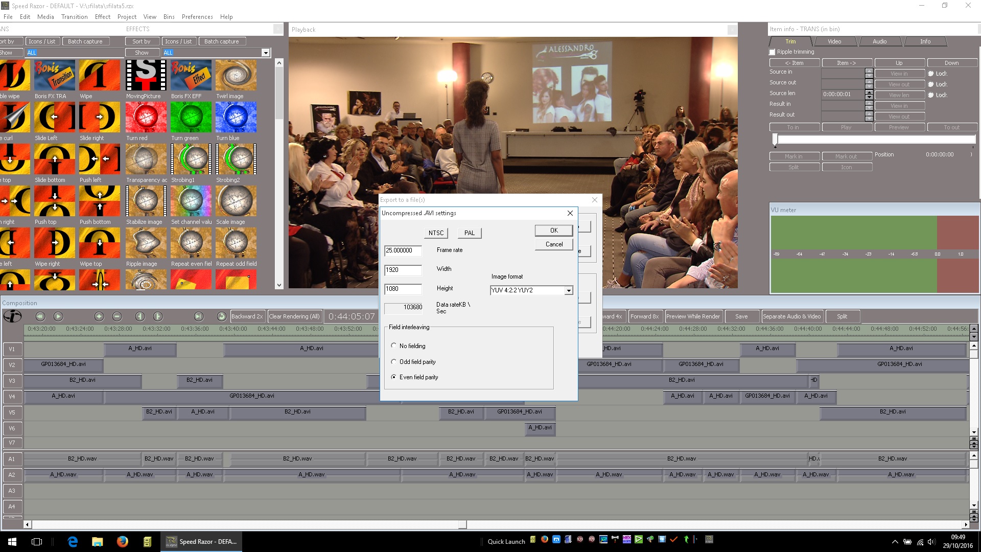

However I attach 2 file export from the nle: one is recognized as "No Fielding" (progressive), and one as "Even Fielding" (interlace BFF). I have analize the header in all the way but I cannot understand where is the differences. The file called "outEVENfielding.AVI" is recognized as right as a interlaced file, but the output of the avfs system is seen as "No Fielding". I don't know if all the question is only a internal flag or the stream type

However both this files is outputted from the catrazor.
The problem is that the output of the avfs system is not recognized from the catrazor as interlaced

the last load outNOfielding.AVI outEVENfielding.AVI are outputted from the **** ***** for **** and in the showned mediainfo are correctly progressive (outNoFielding.avi) and interlace (outEvenFielding.avi).
If you want, but is a little big, I load on my dropbox other outputs of few second in "even field parity" mode (interlace) and "no fielding" mode (progressive), and also in mjpeg (but strangely the "no fielding" mjpeg item is recognized from my mediainfo as interlace).
In Uncompressed the progressive .avi is the one with the 2 images image "stacked"

[Attachment 39151 - Click to enlarge]
Here other 2 exported uncompress
